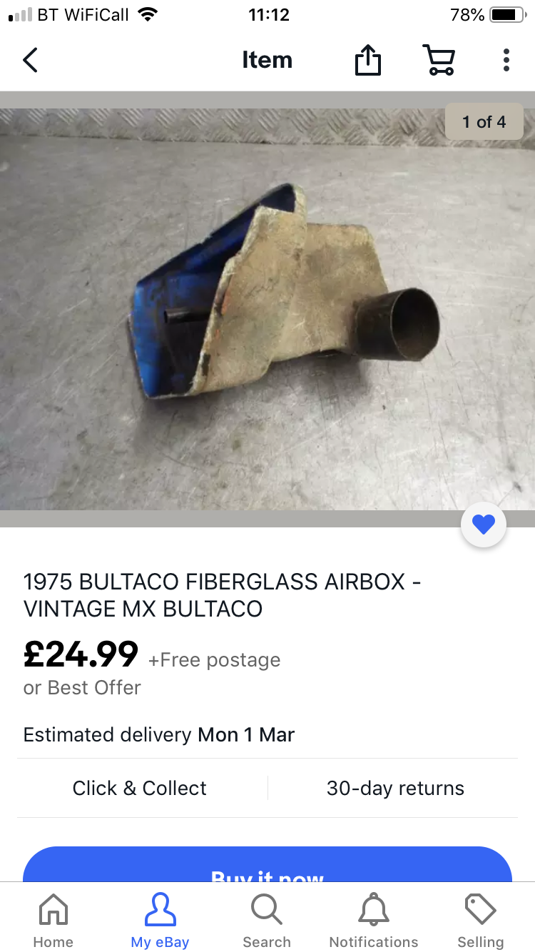

116 Alpina Airbox
99 is like a square steel funnel with flat filter horizontal at the top. 115/116 has a flat filter in a vertical plane in a fibreglass housing
They changed the design to avoid having to remove the tank/seat to service the air filter

You are spot on with that one.
That’s a good price as well.
A lot of the Sherpa riders use this Airbox, as the later type Sherpa199/A/B all had Airboxes that were quite fiddly to access and work on. Especially the one on the 199B.
A good find.

Thanks, that’s reassuring, the seller didn’t respond when I asked which model it was off and I’ve never seen one , missing off my project . I actually got itfor £22 ?
