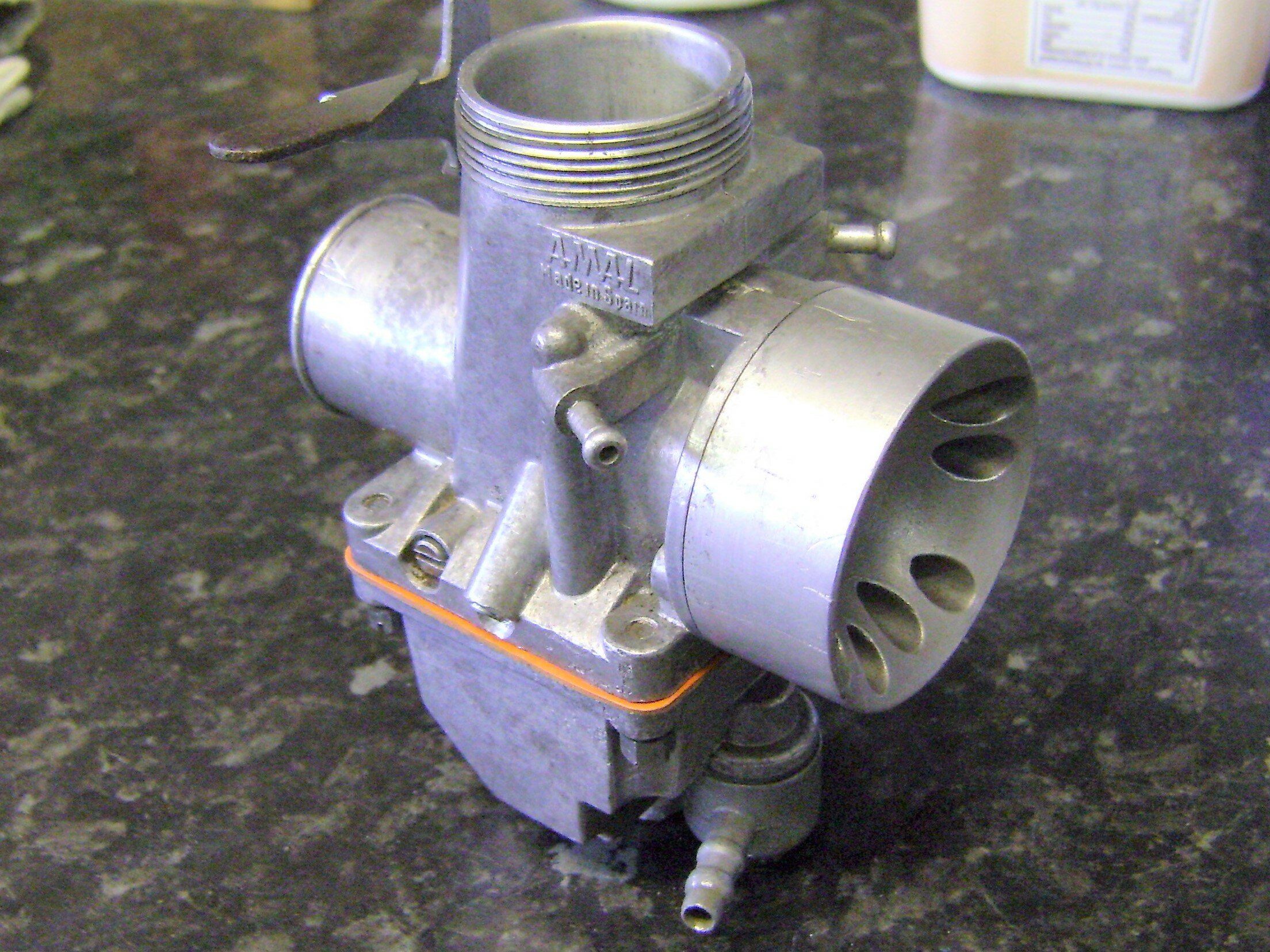

Hi,
    Just nearly at the end of Restoring my 198A. And I have a problem with the Amal Carb. I cleaned it out after soaking it in parrafin for a couple of weeks and fitted  service kit to the carb but the bike will not fire up off the carb. If I tip a little fuel down the plug hole she fires straight away. I have fitted a new needle valve and checked the float is operating correctly, that is shutting off the flow of petrol when bowl is full. I fitted a new needle in the same position as the old one i.e in the middle grove of the 5 grooves.And if anyone has a list of the correct numbers for the jets that should be in the carb that might help.  Any help or advice would be appreciated. I have been advised to bin the Amal and buy another carb but I would like to keep the bike original.
Thanks in advance.

Hi, Thanks to all for the input.
I have stripped and checked the carb again!
It is jetted with the same as specified above.
Given a good clean with carb cleaner and a can of compressed air.
I found 2 blocked jets.
The needle Jet in the bottom of the carb body and the Cold start Jet which took some finding in the bottom of the float bowl.
The numbers on the Carb are "L 2627" and 401.
4 new jets on order so we will see how we get on at the weekend.
Cheers.

Looks like a nice carb, I haven't got any of those on my relics.
