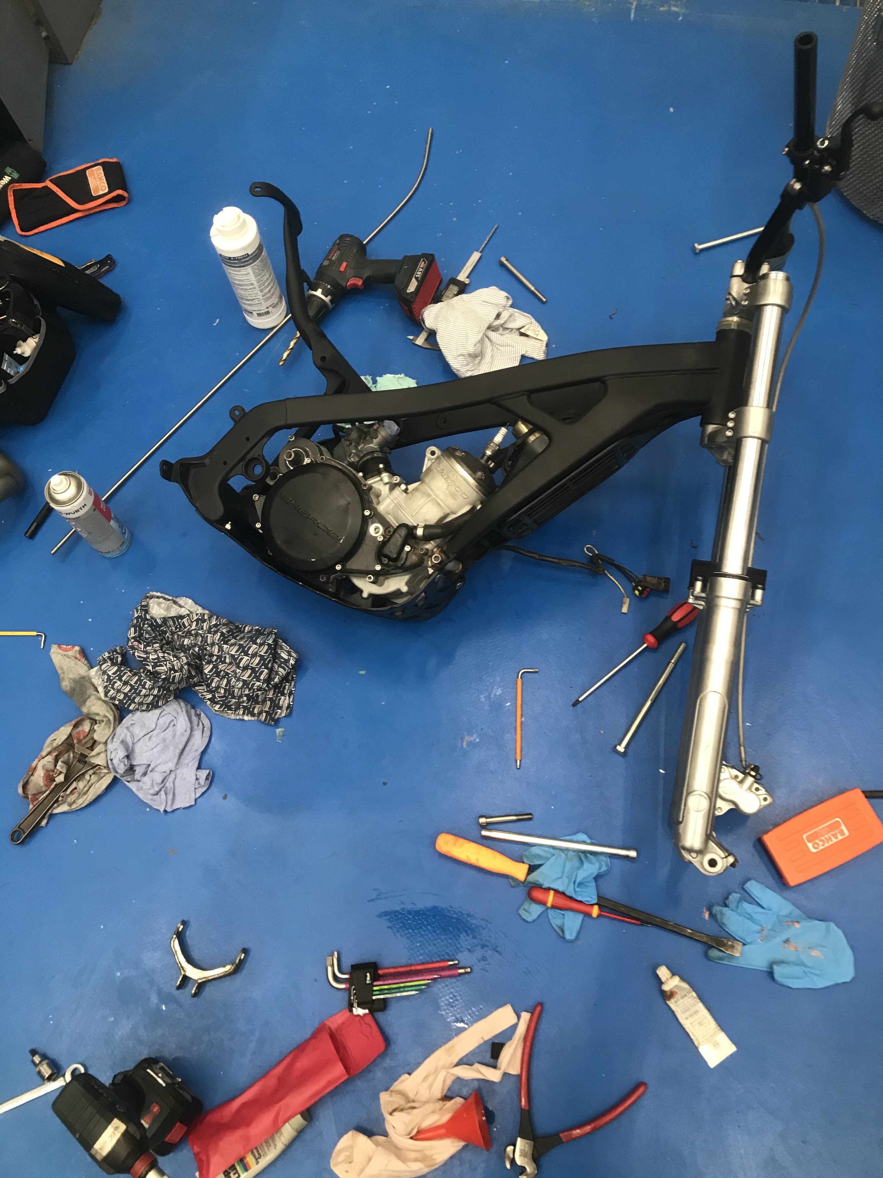

April 2, 20215 yr Hi. I’ve completed a full rebuild of a 01 250 sherco. Bike was a not running when brought. Tried starting it yesterday and found that it would start but only tick over at idle rpm. Throttle position and mixture screw adjustments made no difference. Spark plug very black. Timing light shows around 5 degrees advanced and the stator plate is in the fully retarded position and firing also seems intermittent. I’m guessing that stator trigger circuit or CDI is the issue - anyone seen this before and can suggest anything to try before sending the stator out for repair? Many thanks.
