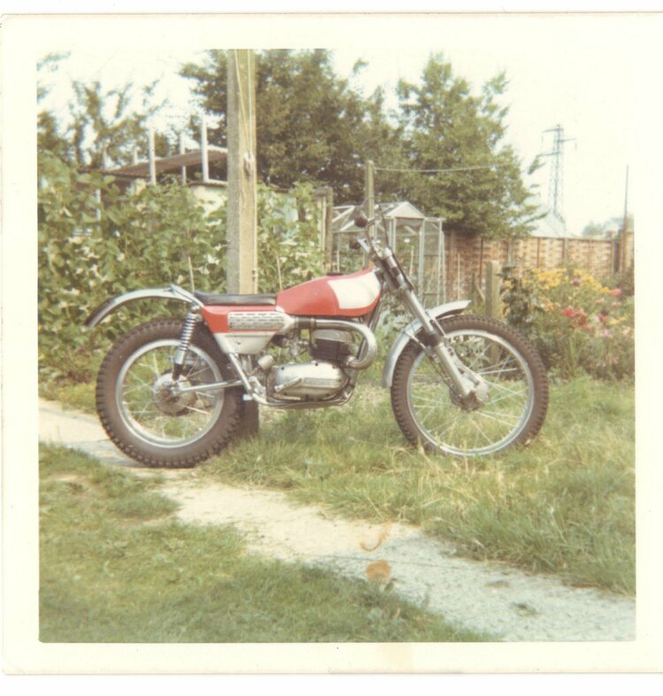

A 1968 Bultaco photographed in 1970 with no mods. I think its a model 49 variant.
