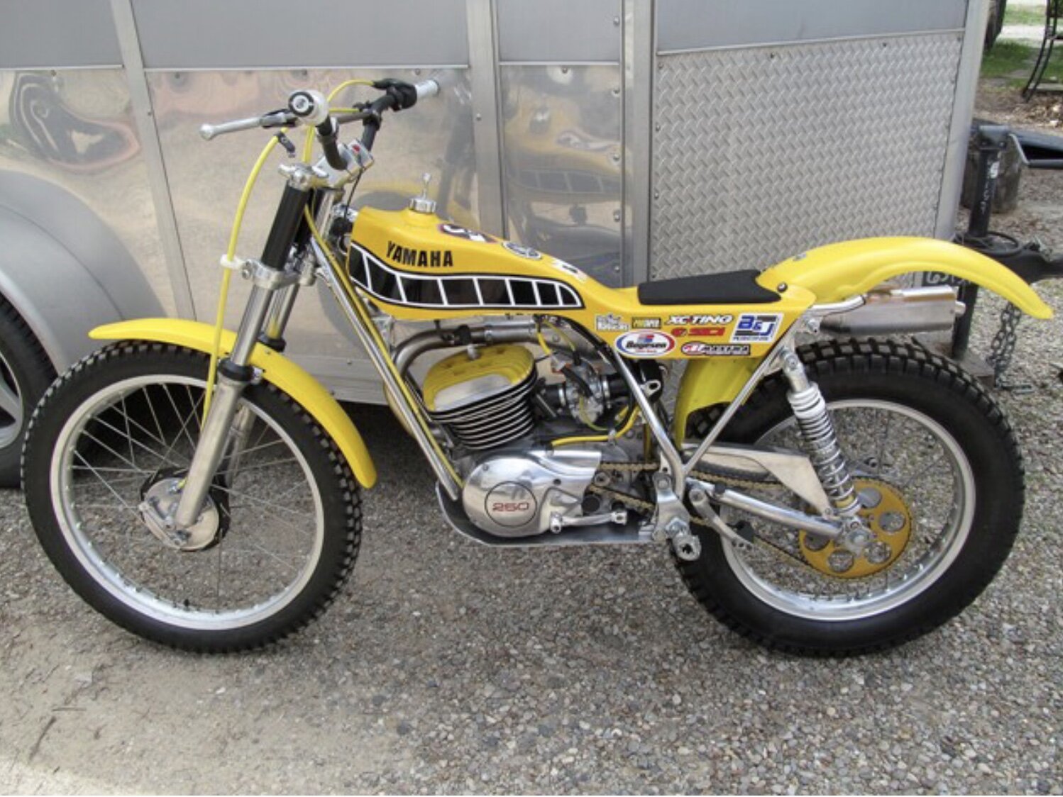

Here's a photo of a TY250 with the later model LH cover shortened found after about 20 seconds of searching google images.
