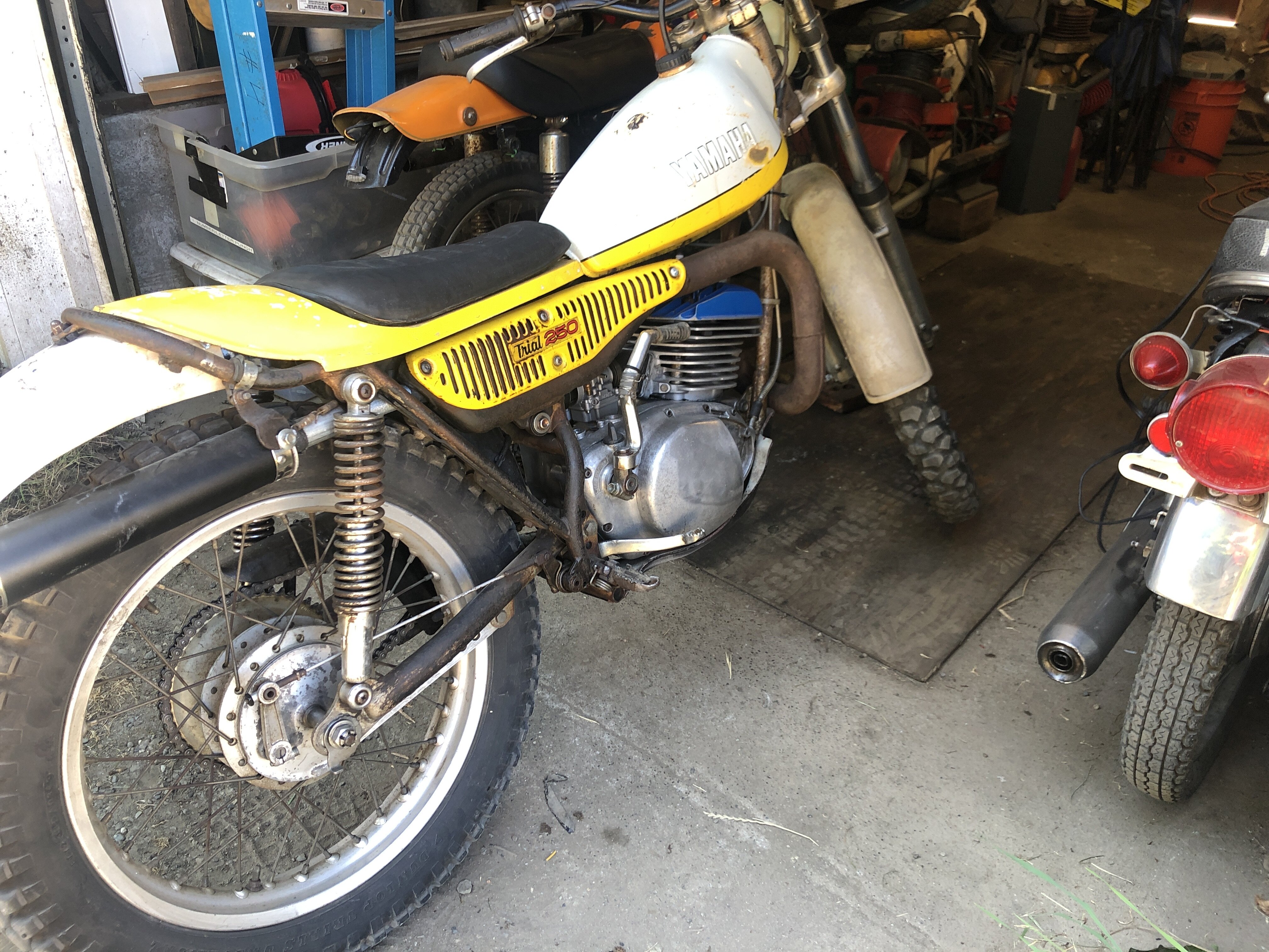

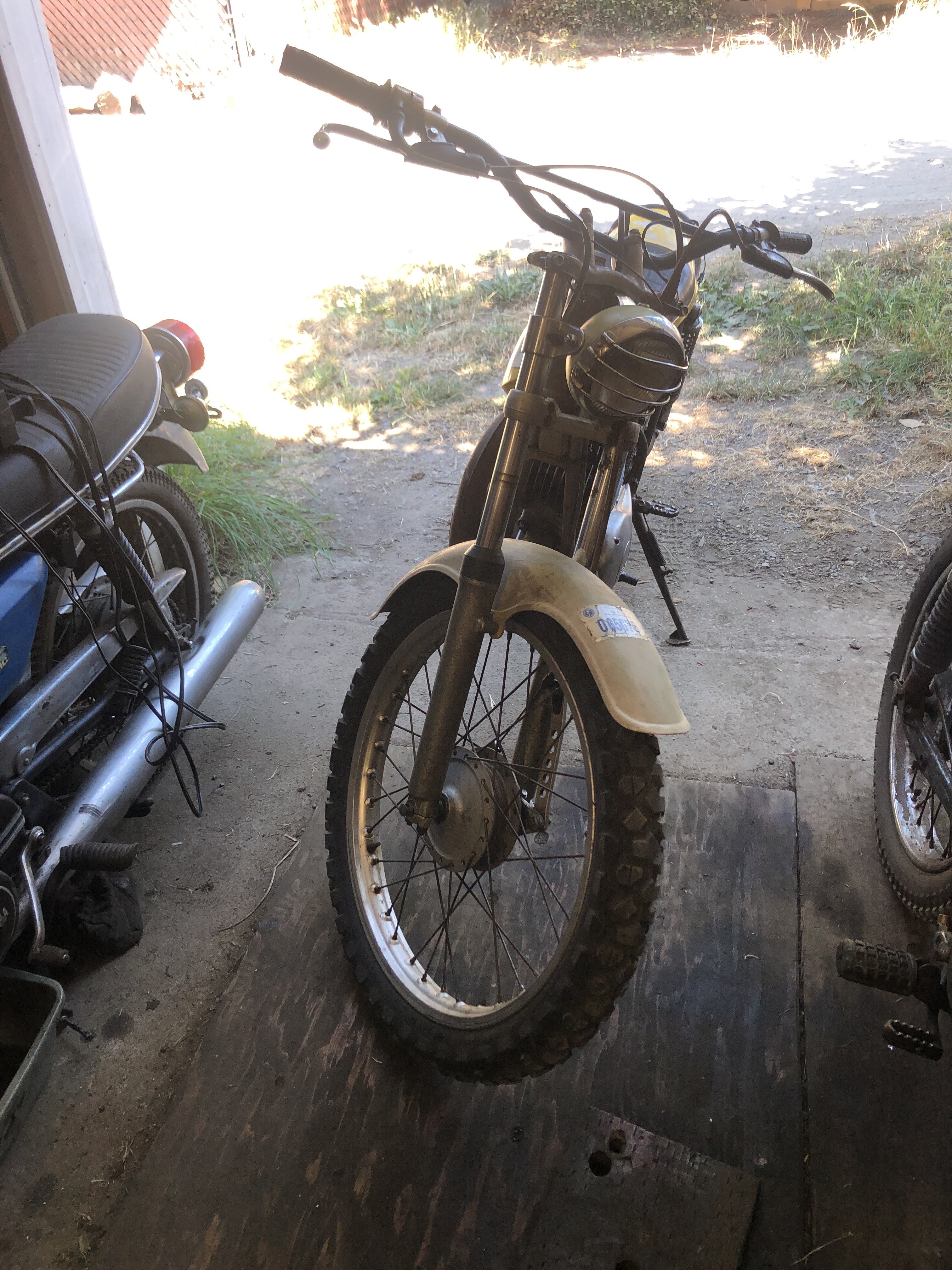

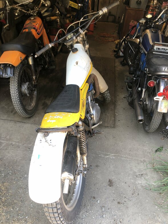

I will take some pics soon and share them on here if you like. Also, Sorry for the novel
Here are some pics as promised. Now bear in mind this was in terrible condition when I picked it up and it’s still a work in progress but at least now I know it’s worth throwing some more shekles at it. It was missing the silencer pipe and of course the noise off of it was pretty sharp to the eardrum to the neighbors, I picked up a generic universal size moped silencer and made it fit until I decide what my options are
