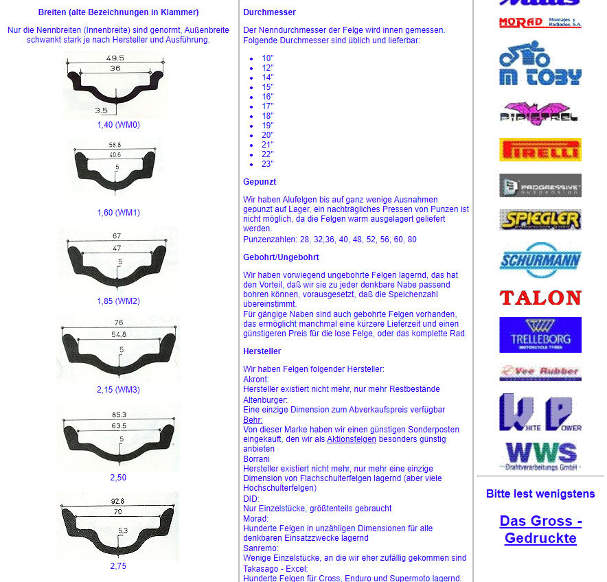

The measurement are made inside the rim the outside might differ and is not regulated.
Here a comparison from LoLo in Austria about the TC (WM) type rims with each cut and where to measure them.
Between the 1.85 and the 2.15 is a difference of 15%, what this difference does is that the broader gap result in
steeper tire walls and thus gives a better bigger and better foot print.
