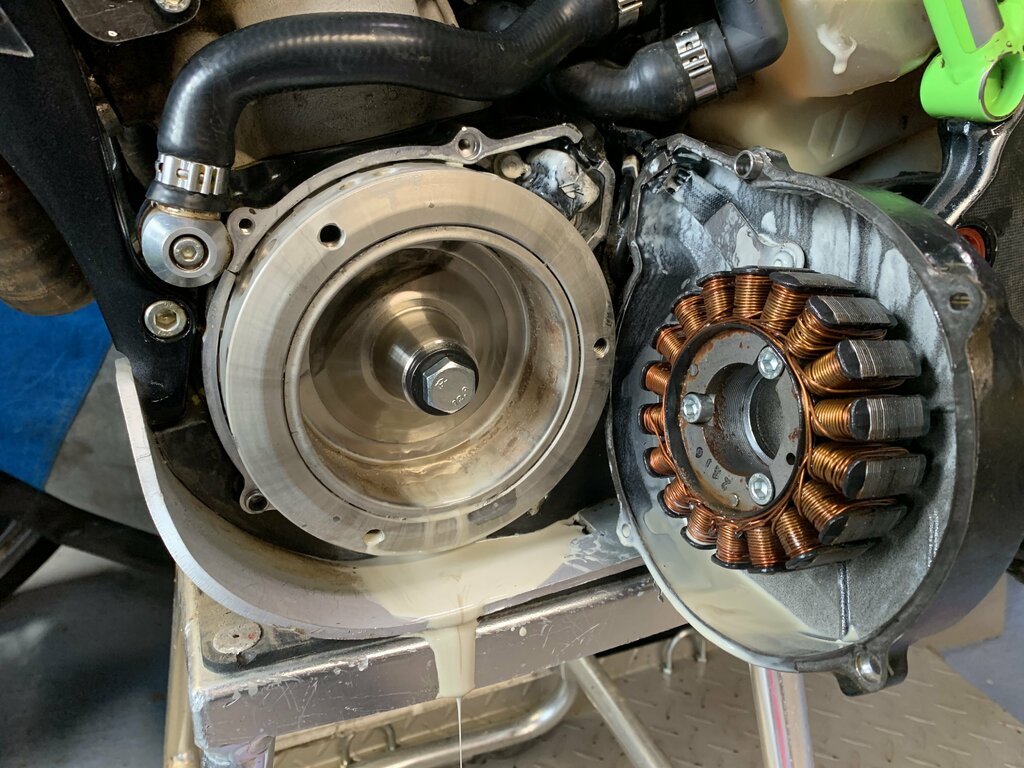

I think the oil leak is the problem. This is what I found when I removed the flywheel cover!
Oh my !
That's not a little bit. Can u update on how the repair is going ?

First thing I need to do is remove the flywheel but am not keen to pay 120 Euro for a Jitsie tool so need to make one and have ordered the metal today.  Will then strip the engine in the bike if possible.
Those flywheels are on real tight, when you make the puller (I used a flange with 3 x M8 socket head bolts with a threaded insert), make sure the bolts go a long way into the flywheel, get a lot of tension on and tap/smack the end of the centre extracting bolt head to break loose the taper. On the older motors, there are no pressure fed bearings, just gravity fed from the gearbox. Check the LHS crank bearing has not failed, you would have heard a rumble by now if it was.
Thanks for this advice.  Hope to build the puller this weekend and have bought high tensile bolts that can be threaded as far as possible into the flywheel.
