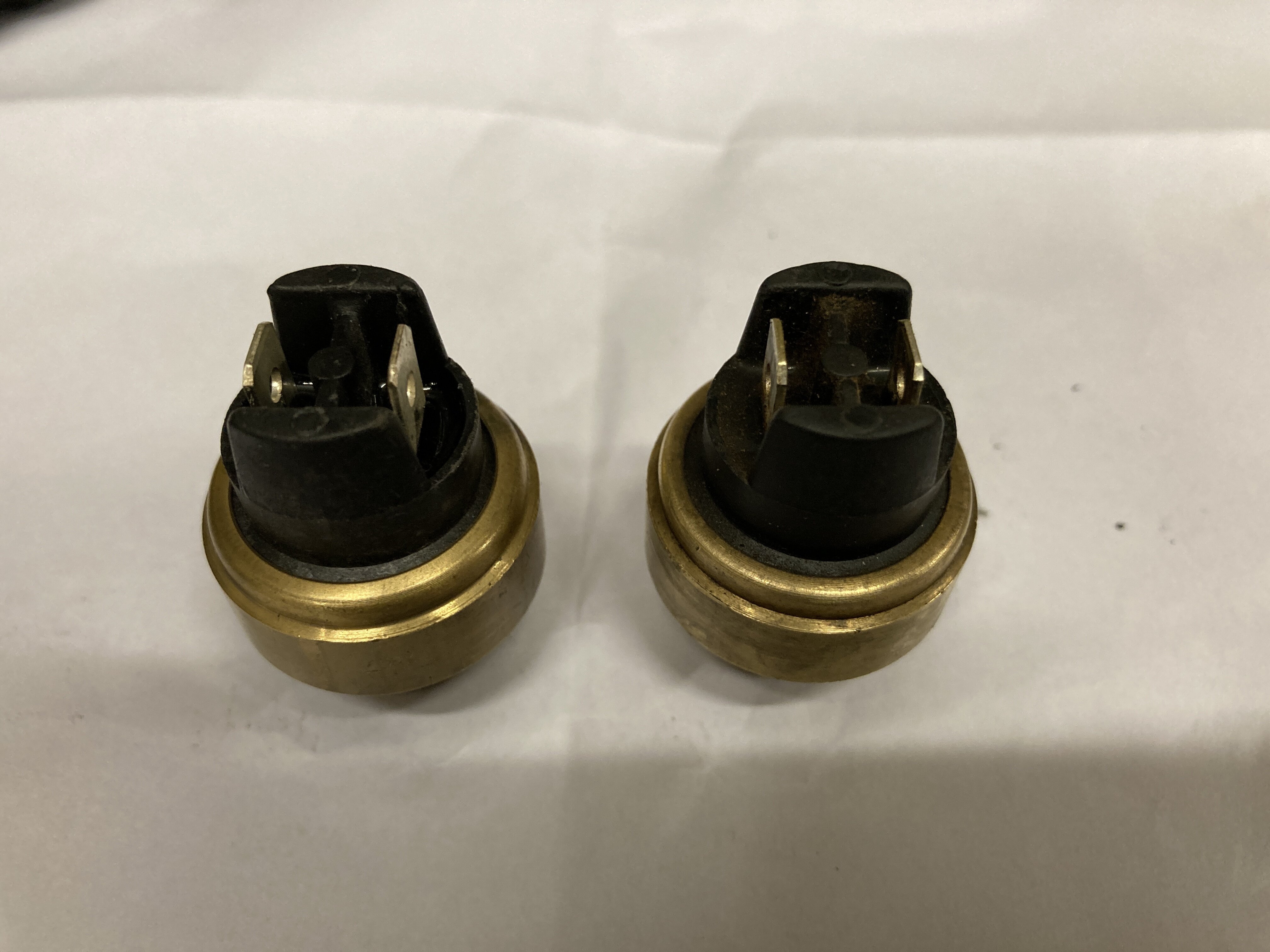

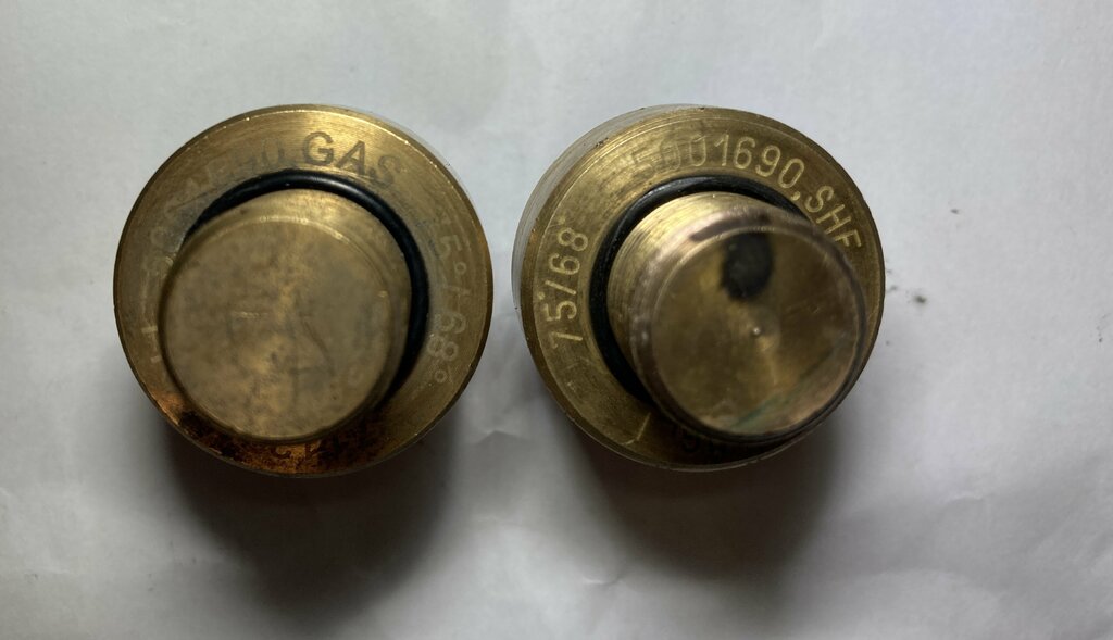

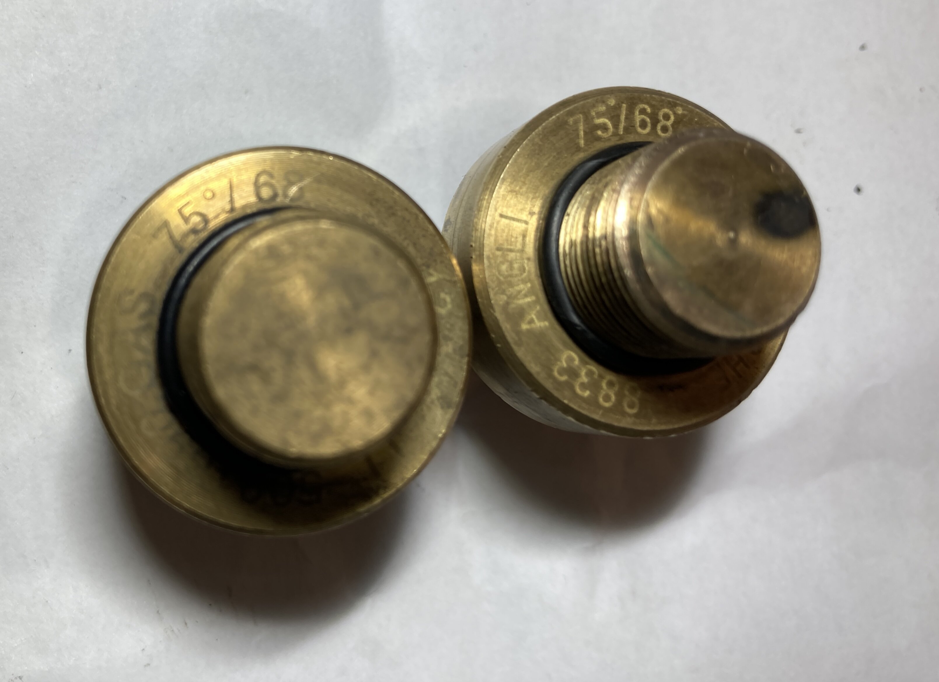

So I ordered the GasGas part as it was cheaper…and it turned out to absolutely the right thing to have done :)
The original Sherco switch and the new GasGas switch are identical parts in every way apart from one has a GasGas part number and the other has a Sherco part number. They are both normally open bimetallic switches that are 75degrees ‘on’ and 68degrees ‘off’. Threads are identical and are M16x1.0 as far as I can determine.
GasGas part now fitted to my 2011 Sherco 2.9 and all is working exactly is it should do.
See photos - the Sherco part is always on the RHS.A3CE481C-42A2-4E40-8250-8D0050FE670B.thumb.jpeg.7640e55a5ab6bb4eb4f304c3c6ef646c.jpegF70E36B7-AAEF-48B2-BC72-37A0C1E5542E.thumb.jpeg.aebbb5cc8b7b968ff02da1088451a3f0.jpegFF108672-A267-4D16-9379-567CD0F26C8D.thumb.jpeg.b6abe4cfe9f162101ebbeefe9df55a01.jpegA637A17B-06C0-4AA5-9E4B-4CDB1CC8B389.thumb.jpeg.706b4ef3db109076ae95b29ce74cb9f6.jpeg
