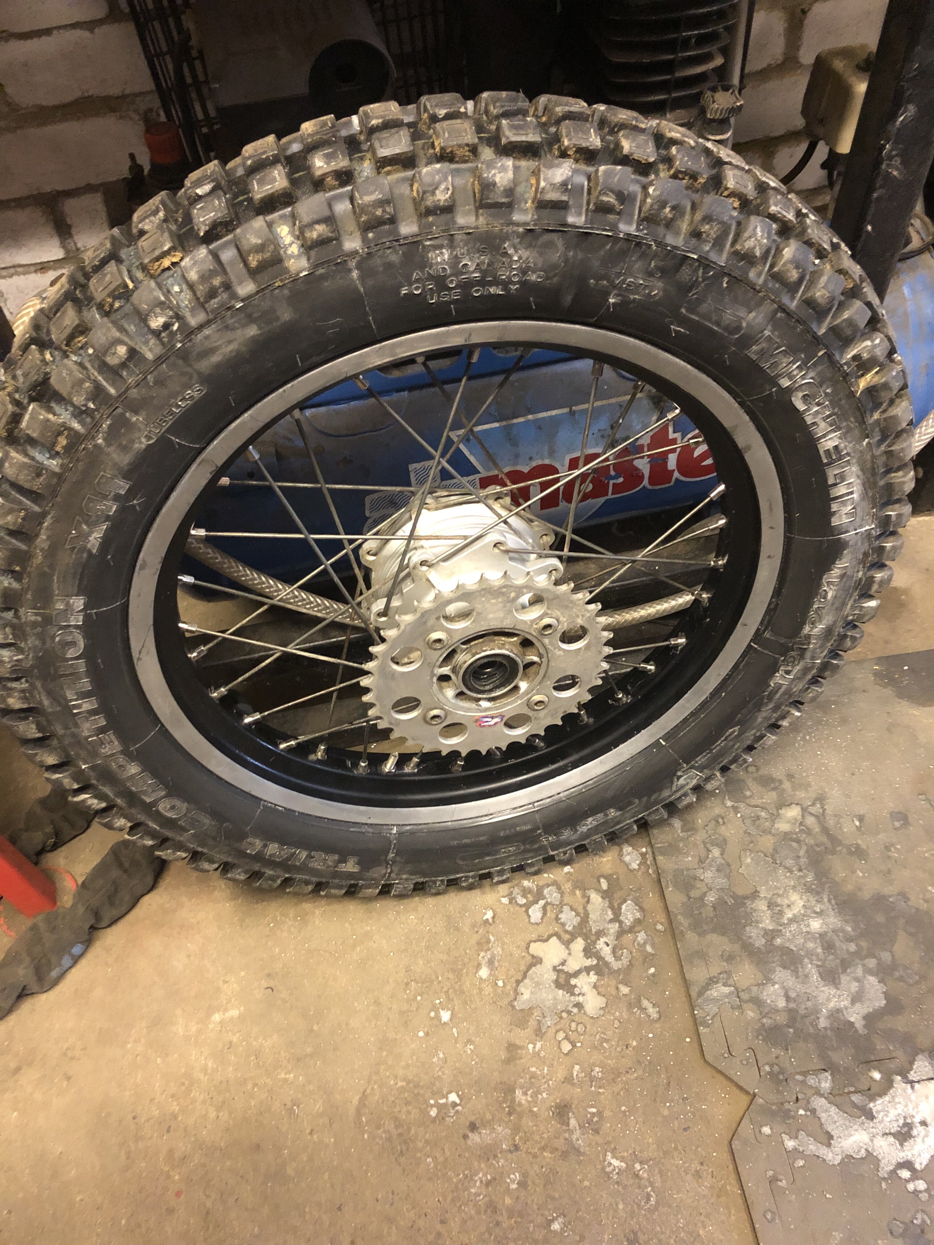

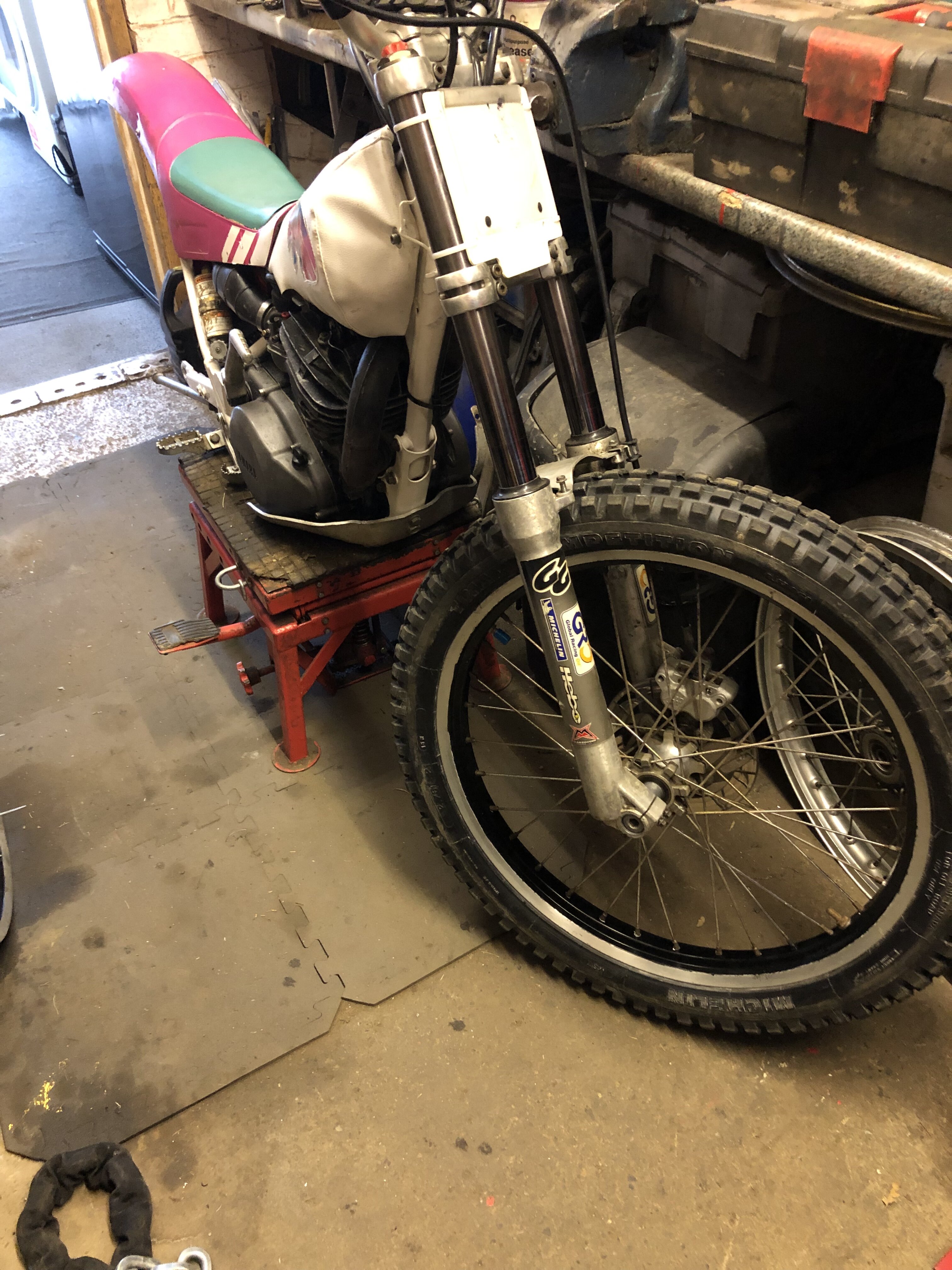

Get the right bearings and a 4mm spacer and its plug and play for the front end. I had the rear rim re drilled and built onto the original yam hub. Difficult to do but possible or send it to sids wheels for a proper job

That..is just awesome 👍
