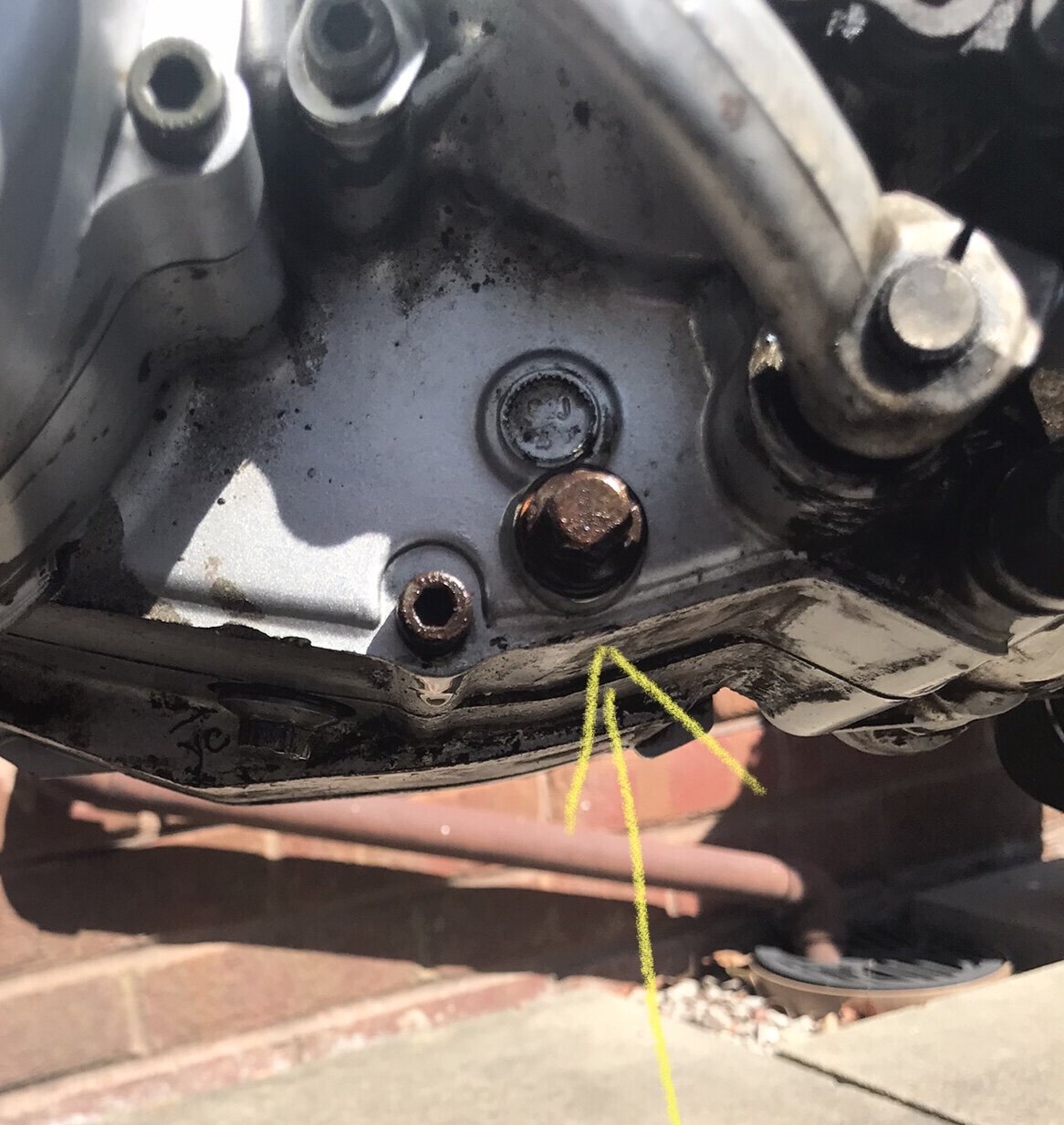

Maybe share a photo of the drain plug you are seeing

Left hand casing sorry. Hope this makes sense?
I don't remember having that drain plug on my 1993 TY250Z.
I just looked up some parts fisches for later TY250Z models and from those it looks like that plug was a change that was introduced after the first model TY250Z.
Both drain plugs are in the gearbox section.
Two possible reasons for that second drain.
1 It could be for where a switch is fitted to some other Yamaha model that shares the same engine casing and has a neutral indicator (perhaps TY250Z Scottish).
2 It could be so you can drain the oil without removing the bashplate.
