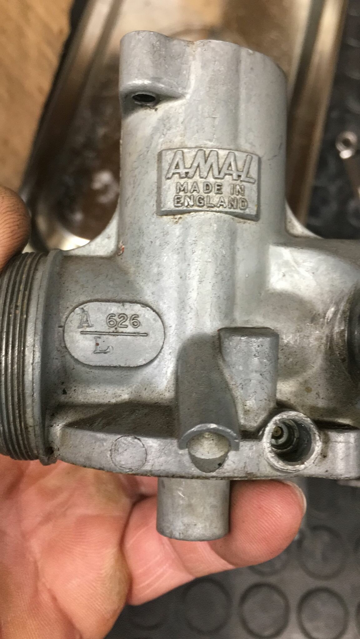

November 11, 20224 yr Hello all I'm after some advice please. I have a bsa b40 with a wd engine. She's been sitting for a while and the carb has all disintegrated. Could anyone tell me what AMAL carb it has fitted please so I can try and source another. From what I can see it's a 626 L but all the one's on the net seem to be L and three numbers. Many thanks
November 11, 20224 yr Original Amals and modern Amals are stampled up differently. On yours, the L means left hand which refers to the tickler and usually, the pilot and idle adjuster screws as well, although yours seems to have the tickler on the left and and right side adjuster screws. The 626, 6 means 600 series and 26 the bore, ie: 26mm If you're buying a new replacement, all you need is a 626, decide whether you want left or right hand, state the jet sizes, slide number and specify that it is a 4 stroke carb as the 2-stroke jets and needle differ. The 4 stroke dioesn't use a pilot jet in the base of the carb as there is a pressed in bush behind the pilot adjuster screw instead I'd be certain your carb isn't seviceable before buying new as they aren't cheap any more.

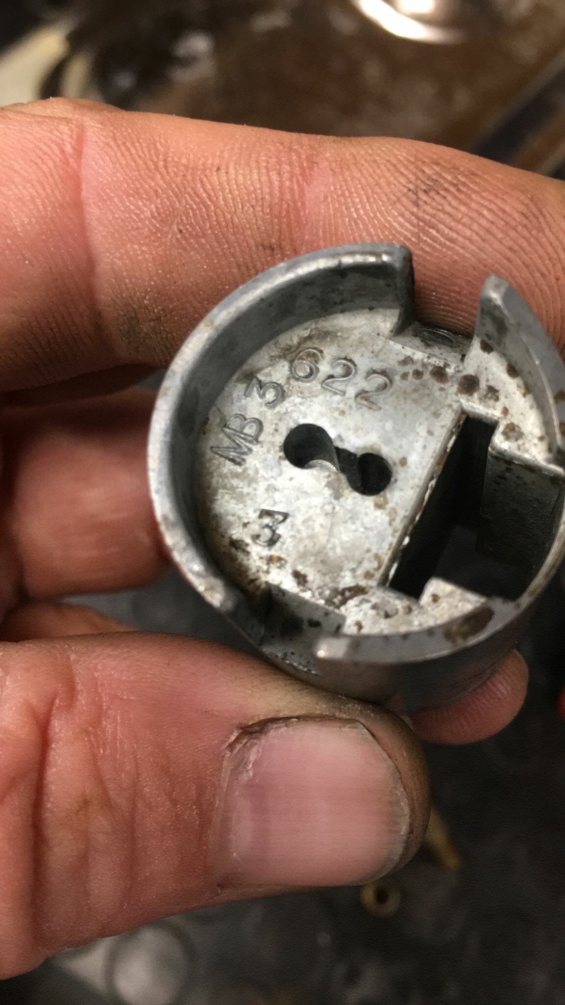

November 11, 20224 yr We are looking at the right side of carb so L(left hand) looks to be correct. No 3 throttle slide is quite normal. My guess it has worn out in the body and throttle slide as they often do. Buy parts or carb from a reputable Amal dealer as some seems to sell strange combinations of parts that may affect performance. During the years the carb went through a number of modifications and they may or may not work together and may affect performance. The 626 (26mm) has a smaller body then a 928 (28mm). Amal carbs are simple but the modifications and differences makes it to a whole science to get them correctly set up. My opinion is when they are correct they work amazingly well Do not pump the tickler. Press it down until you see petrol coming out. My guess is you can omit the choke slide and start he bike from cold, only using the tickler. Should be tested before first occasion. Remember, 4-strokes often leaning out mixture somehow when opening the throttle. Thus the need for accelerator pumps or CV-carbs. 2-strokes don´t do this https://amalcarb.co.uk/ https://accessories.hitchcocksmotorcycles.com/Amal-Carburettors

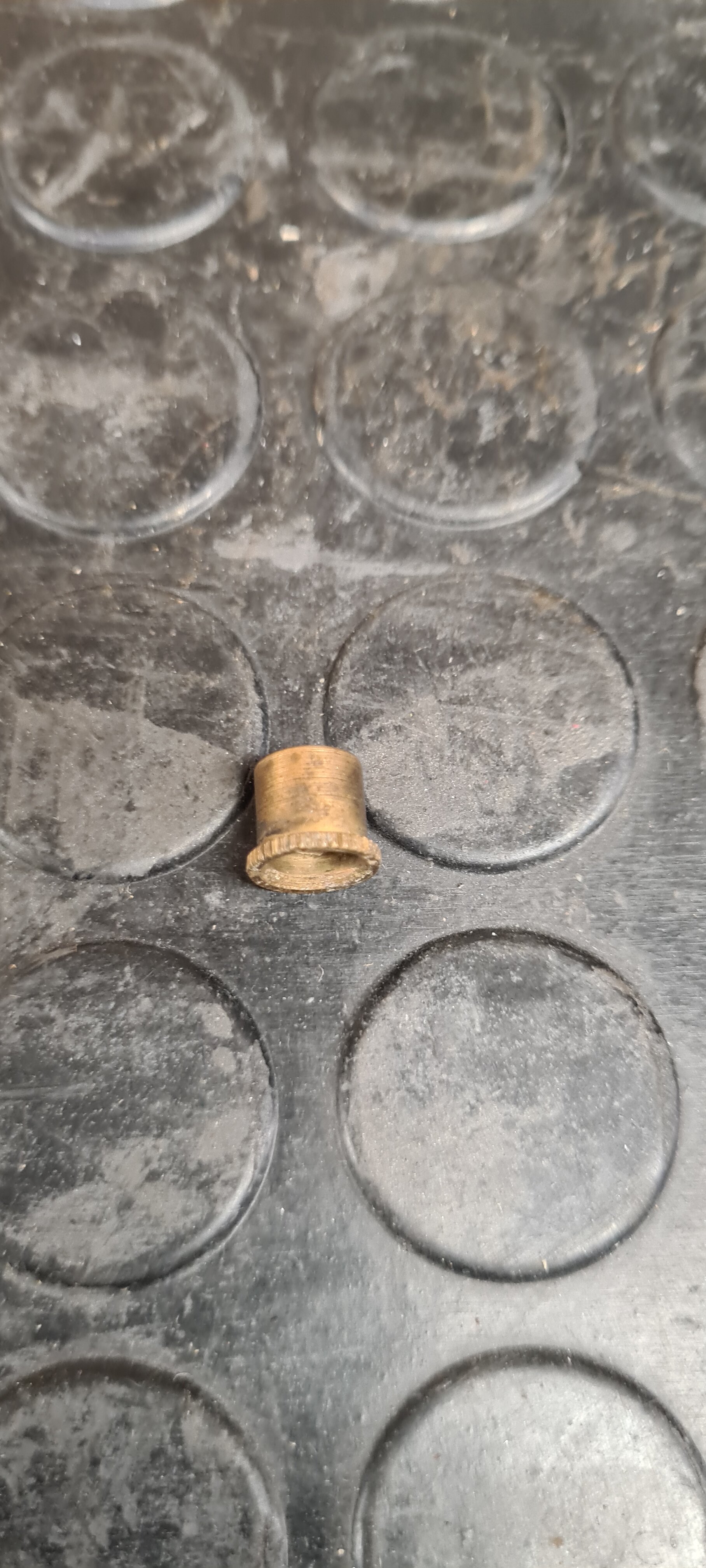

November 13, 20224 yr Author Thanks to you 3 that replied all that was very helpful. Is this Bush the only difference in a 4 stroke carb to a 2 stroke one? Could I get a 2 stroke one and swop my internals over? Many thanks
November 13, 20224 yr The brass insert where the needle goes through the ventury are different One is square at the top the other is cut away I use the the premier type on my cub The body uses a better alloy and the slide is coated
November 13, 20224 yr Author 43 minutes ago, naichuff said: The brass insert where the needle goes through the ventury are different One is square at the top the other is cut away I use the the premier type on my cub The body uses a better alloy and the slide is coated Would you know if I can put my brass round 4 stroke one in there? Would it work
