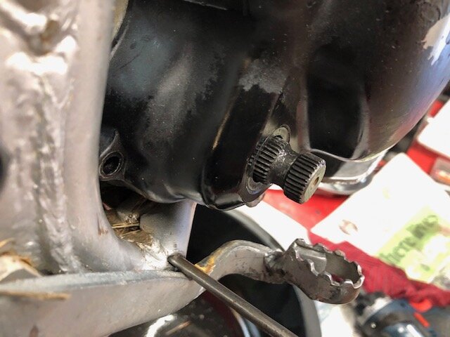

This is what the RT cover looks like,  There is not quite enough room for the kick starter on the shaft.
Edited by mcman56
