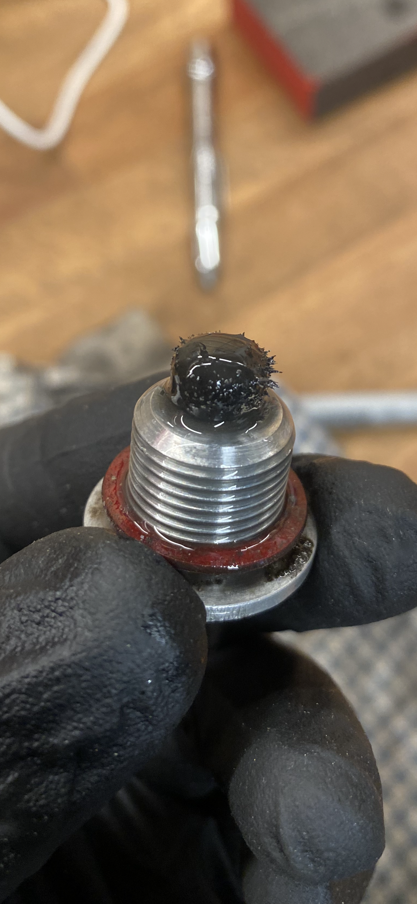

Is it normal to have metal swarf on the magnetic sump plug?

If it's a grey , fine paste on the sump plug  - yes. If you can feel anything - no.

Is it normal to have metal swarf on the magnetic sump plug? No. If you want help on here, post a photo of the swarf.

No definitely see swarf IMG_4948.thumb.png.6a673f3b0d65b58736d0833e3272e2f0.png

Without gloves, can you feel anything ? If yes, I'd definitely be splitting the cases.
Probably need new casing, over time the coolant corrodes and leaks thru into gearbox, common fault on old betas unfortunately
