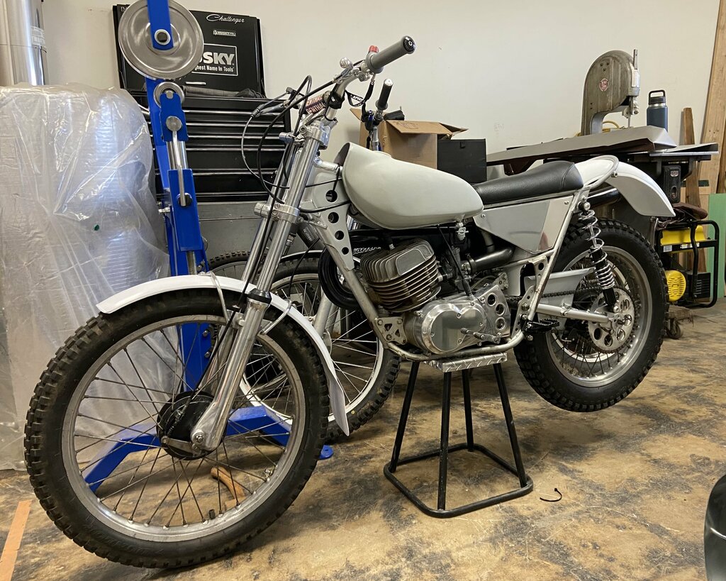

lemur Posted July 21, 2023 Share Posted July 21, 2023 That doesn't look like an exacta alloy fuel tank, looks more like a steel Yamaha TY tank. Problem with the rear end is, the countershaft sprocket is a long way ahead of the swing arm pivot point and the original swing arm is very short. If you alter the rear suspension and sprocket size significantly the rear end starts doing the pogo-stick motion. Angle at the steering head is definitely the source of the slow steering and the leading axle doesn't help that situation. I agree on not wanting to chop the frame and it's a shame you can't adjust rake at the triple trees like they did with choppers in the olden days. Stock forks are spindly and the stanchion tubes are very close together which also limits the lock to lock. The biggest improvements you can do to the bike over stock OEM is to run modern radial gummy tires 👍 and improve the bash plate coverage. Quote Link to comment Share on other sites More sharing options...
diagnosis Posted July 21, 2023 Author Share Posted July 21, 2023 Good eye Lemur, it is in fact a TY250 alloy tank. I intend to make a tank for it at some point, maybe similar to a Sammy Miller style Yamaha, or the Holtworks RL250 version. Hopefully the gearing works out, as teamferret mentioned, I have installed 360mm Betor rear shocks as the originals were blown. This is the current state, as of this afternoon. I still plan on filling some dents in the tank, repainting, and adding a 2k clear, lengthening the kickstand, and replacing the rear brake cable, but otherwise, I’m pretty happy with it! 3 Quote Link to comment Share on other sites More sharing options...

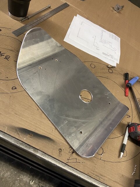

diagnosis Posted July 28, 2023 Author Share Posted July 28, 2023 (edited) On 7/25/2023 at 3:23 AM, esuark7 said: there was something on this site before but can`t see it now worth a try https://www.beamishownersclub.com/ I’ve yet to contact them regarding the guard, but once the suspension is loaded while riding it, the rubbing doesn’t seem to be a problem, thanks for the heads up though! I made a skid plate for the RL today, and took it for a ride around the shop for the second time since I’ve owned it. It feels really nice, although longer than I initially remembered. Adjusting the bars back should solve that issue. There are still a few things on the to-do list, but I’m almost ready to hand the kill switch over to my Dad. - There is a carb leak, I’m guessing around the bowl gasket. I cut a new one out today, as the old one was cracked and no longer working either, but didn’t seem to solve the problem. I’m considering just grabbing an OKO kit from Midwest Atlantic Trials, as the one I bought for my TY175 works flawlessly so far, and is priced reasonably. - Seems like there is excessive smoke at startup until it’s fully warmed up, then it’s tolerable. I’m guessing crank seal? It’s fresh 90octane at 50-1 with synthetic oil mix. - Still want to paint and finish tank ‘properly’. It’s just been spraybombed with white Tremclad, and isn’t fuel resistant. I have decals being made, so once they arrive I’ll focus on that. - The kickstart lever is incredibly worn and flops like crazy. I tried building up the stops with weld, but that didn’t help at all. Are there any other Suzuki’s that shared this kickstart design that could be swapped over? Again, I appreciate all the feedback, and suggestions, this bike is a bit of a mystery to me, but seems to be coming together better than I expected. 🍻 Pics from today: Edited July 28, 2023 by diagnosis Quote Link to comment Share on other sites More sharing options...
