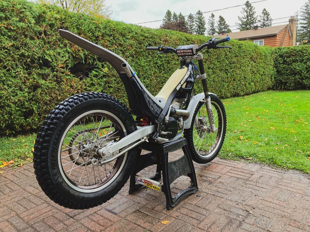

JimLepage Posted October 17, 2023 Share Posted October 17, 2023 Hi there ! New here and new to trial bikes. I bought a pretty clean bike but the shock is dead. I searched a lot online but the replacement/upgrade options seem really rare. Anyone knows about a good shock option ?  I don't want to rebuild the stock Olle, I see everywhere they were weak from start.🤘 Quote Link to comment Share on other sites More sharing options...

pauls320 Posted October 18, 2023 Share Posted October 18, 2023  TRP and the Ohlins are both great options and they work well (have both) but realistically the stock Olle if its not sacked out, is all most of us really need for trail, clubman stuff. I do have a very nice Olle hanging on wall. You wouldnt happen to be in Chinada would you? ?  (That is an interesting rear disc guard you got there) Quote Link to comment Share on other sites More sharing options...
JimLepage Posted October 18, 2023 Author Share Posted October 18, 2023 8 hours ago, pauls320 said:  TRP and the Ohlins are both great options and they work well (have both) but realistically the stock Olle if its not sacked out, is all most of us really need for trail, clubman stuff. I do have a very nice Olle hanging on wall. You wouldnt happen to be in Chinada would you? ?  (That is an interesting rear disc guard you got there) The guard was on the bike. It's pretty nice. Yes I'm in Quebec City. 1 Quote Link to comment Share on other sites More sharing options...

pauls320 Posted October 18, 2023 Share Posted October 18, 2023 Good stuff, okay too far away then. Trials suspensions are generally not as sophisticated as enduro/mx , has the oil leaked out of your shock, possibly just rebound screw adjuster is wound all out?  Quote Link to comment Share on other sites More sharing options...
JimLepage Posted October 18, 2023 Author Share Posted October 18, 2023 3 hours ago, pauls320 said: Good stuff, okay too far away then. Trials suspensions are generally not as sophisticated as enduro/mx , has the oil leaked out of your shock, possibly just rebound screw adjuster is wound all out?  I'm gonna look at it next time I work on the bike. Quote Link to comment Share on other sites More sharing options...
JimLepage Posted October 19, 2023 Author Share Posted October 19, 2023 If someone else search the same thing as me in the future. That shop list some shocks for our application. https://www.dherbeymoto.com/marchand/piece_detachee_p1.php?num_rubrique=4&num_type=209&page=piece&num_rub=4&type_recherche=piece But I finally bought a Ohlins on eBay.  🤣  Brand new, only mounted on a show displayed motorcycle. Quote Link to comment Share on other sites More sharing options...
