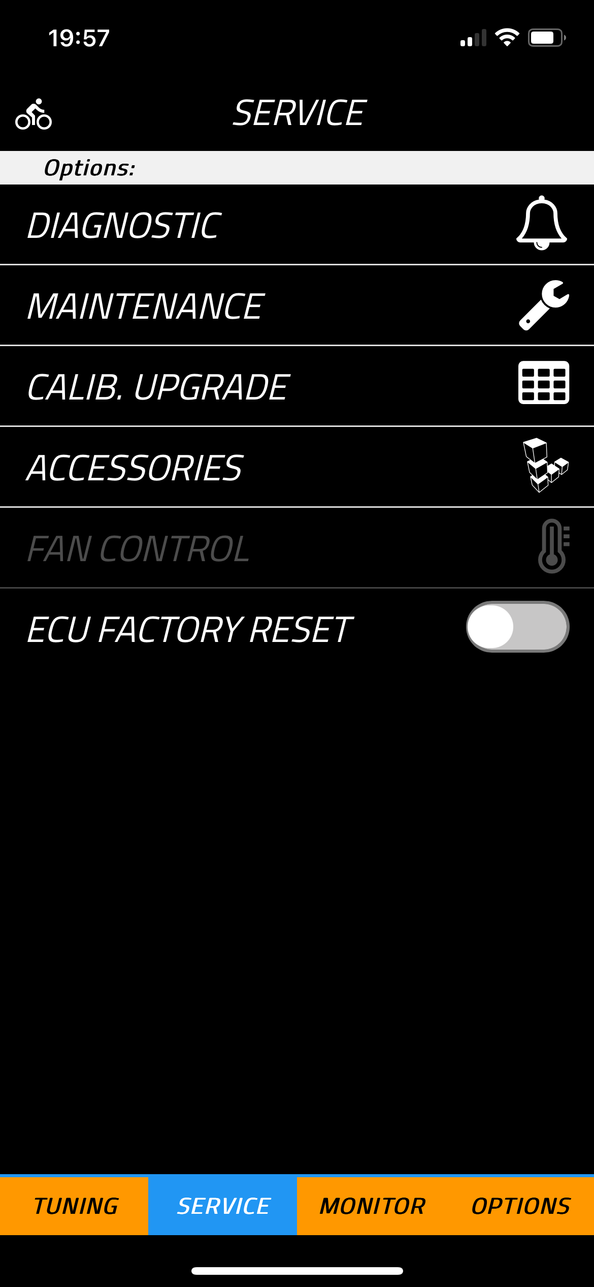

Fan was on constantly on last ride out.Coolant checked.Attached my GET WiFi reader and it showed nothing.Except fan control was blocked out?Temperature sensor read open circuit for resistance between ground and terminal with wire disconnected?Seemed to be cutting in and out tonight when testing?Anyone seen this before of any ideas?

Do all Vertigos have the WiFi  GET I thought it was just a GET ECU without WiFi    I have the WiFi GET on my KTM 500 that is a option
