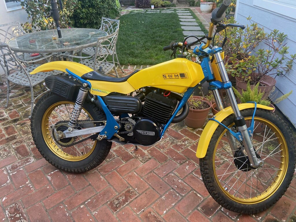

I am the new proud owner of a 1983 SMW 350 Jumbo, in all it's yellow glory.  Bought it from a local rider (thanks Wayne!).  The engine has been fully rebuilt and has just a couple of hours of riding on it.

I am on the heavy side so I'll need stiffer springs (it just bottoms riding on the trails!).  What's the recommended rear shocks and where to find stiffer springs in the front?

Very neat looking Hydraulic clutch conversion.

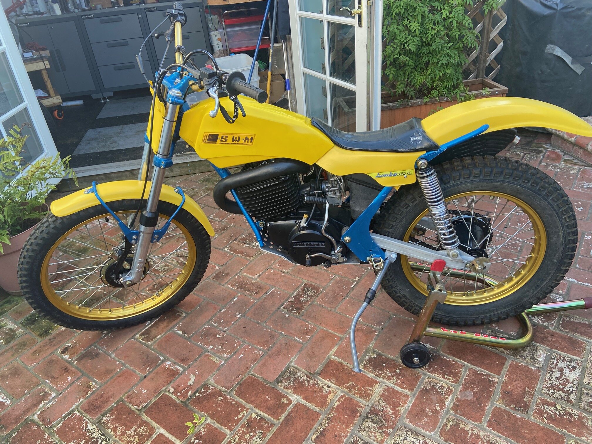

The rear suspension looks not to be original and the spring with its many windings looks too to be on the soft side, you might look up Rockshocks from Gary Fleckney.
