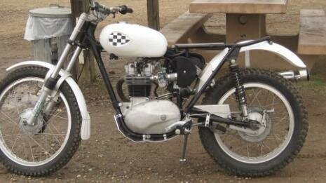

I don't remember all of the details but I put a Bultaco Alpina rear wheel on a 1965? C15.  I probably had to make wheel spacers but don't remember having to do anything else to make it fit.  I also installed the Alpina forks and front wheel.  As I recall, the rear Alpina brake worked well but the front was terrible.  There was not a lot of forethought but the bike turned quite well.
When my c15 had a modified original  frame it had a triumph cub hub
