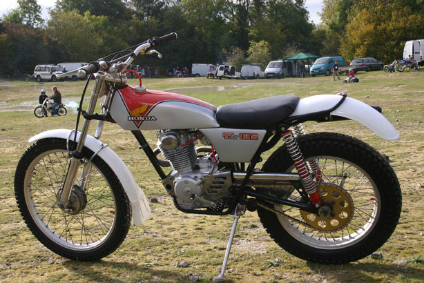

Thought some of you may be interested in a TL I built a couple of years ago.
It started with a

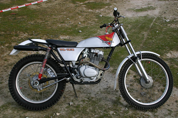

I shortened the cam ( about 10 cm's I think ) but the location tab for the
advance retard is in a different place. With carefull comparison I filed
another groove in the advance retard mechanism to put it where it should be.
You will need the TL primary cover as the brake lever will cause problems,
but I had to build up a little with plastic metal on the bottom left,
obvious when you look.
You also need to grind a little frame away at the back and enlarge the bolt
holes.
The key is to have plenty of bits to play around with, recon you are OK
there!, the XR was not available much over here so parts were not so common.
Finally spray it silver so it looks standard and amaze your mates.
