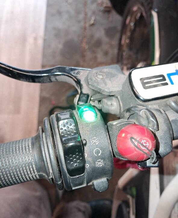

Hi guys.
I've got a new to me em 5.7  around 2012 (no idea how to figure out the year)
Basically the green light is always on.  No matter if the battery is switched off or the switch gear is off.
The only way I can turn off the green light is to disconnect the wiring at the 2 amp fuse .
The handle bar switch appears to work for killing the bike. But the green light remains on regardless.
I'm guessing this isn't right.  I'll pull the switch apart and have a look. But any advice appreciated.
Cheers
Ok. Managed to sort it.

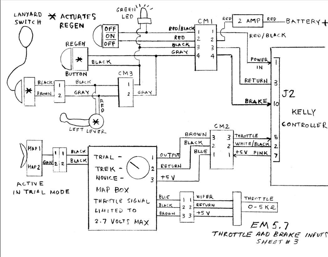

The wire from the led was crimped to the red wire instead of the switched red/black wire.
It looked like a factory crimp inside the loom.  Also found a resistor in the same handle bar loom. 🤷 Not sure what that's about. But I'll leave well enough alone. It's working sweet as now
