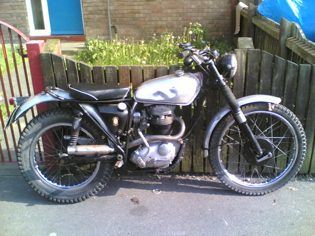

Could any one please tell me where i could get the regulations for the ssdt. I have a 1968 b40 does any one know if it is eligible for the pre 65 trials . I know this was made after 65 but they were in production befor . Many thanks Dave

B40 is ok for brit bike trials, the pre 65 lable is not what it means just a general expression. Try the SSDT forum for more info on that event. Cheers :wall:
as the regs have gone from the website the rules are essentially that as long as the bits were commonly available pre 65 and made in uk your ok , carb cant be anything more exotic than a mk1 amal and forks can be anything inside as long as externally their p65 no tubeless tyres that about covers it ..

I dont know a lot about old bikes but looks like its got the right age bits on it to me

Dave your bike would be fine for pre 65 trials in fact i remember i put a bid in on it :wall:
However your post asked about the scottish pre65 event which is an entirely different can of worms as you may have gathered from the responses.
Think after looking closely at your bike that the guy is just trying to get out of the deal. I remember your listing and there was nothing wrong or infered in it. The bike would be fine in almost any center i can think of, just take the number plate off, just perhaps uncompetitive as most B40's are pretty tricked up. You still have to ride them though as i recently found out :D
