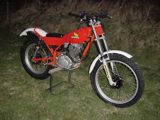

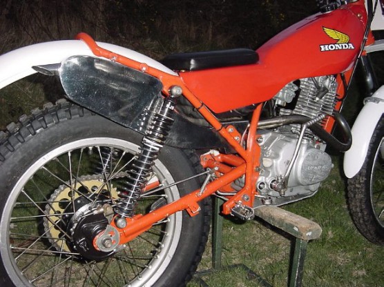

Hi.
I have one of these lovely little trials bikes. I use mine here on the Isle Of Man in our very active trials centre. From what I can gather Colin Seeley built the frames, as the sticker on my tank states "for Honda UK" and his brother Richard Seeley built the engines and gave them his own engine numbers. Mine has Marzocchi forks. The fork clamps. I can't decide if these were made by Seeley or are Marzocchi too. The rest of the bike appears to be Honda TL. Ie the hubs and brake shoes. I love the hand made appearance of the air box and beautiful ally tank under the fibreglass seat / tank unit. (although the work is excellent) It is so typically british and each bike must have taken forever to manufacture, and must have cost a fortune when new!
I've recently finished restoration of one. Had posted pics on the old TA forum. Turned out to be a long, slow job but worth it at the end!! Got it 6 months before my 21st......finished it and rode my first trial on it about 4 months ago......at 24!!!! The Exhaust was the biggest problem, not one to be found anywhere, eventually got one made by a guy who did it "just for the challenge!!"
Parts wise, the enfine is based on the XL185, bored by RSC (now HRC), different profile cams put in and other internal mods. I did a full engine rebuild, base gasket, side casing gaskets, timing chain etc, all from the XL185, regular over the counter stuff. Piston, rings, small end, gudgeon pin, clips, all came from Wiseco in the UK. All you need to do is get your cylinder bore measured professionally then download the online Wiseco catalogue & match to the size you need. Head gaskets..........Well Ishy knows the story with this one..... Obviously since it is a 185 bored to 200, finding a head gasket to suit was impossible, nearly as bad as the exhaust!! Eventually contacted a crowd in the UK Clough Croydon (now Ashton Seals) who took the original and manufactured 10 for me!! That was the smallest quantity they would do - Ish, will have your 2 in Scotland, cost you a few pints though!! One thing to look for is wear where the cam sits it the head.
Had problems with carburation, but the previous owner had messed with jets, in the end had to bring it over to a friend in Wales, strip them side by side, and transfer parts!! All sorted now though and a fantastic little bike, well able to p*ss off guys on their new bikes (though have been known to do that on a Tiger Cub at times too!!)
Anyway, will pull the covers off her this evening and get some new photos to post. If you need any info let me know, will try and help wherever I can....
STU
