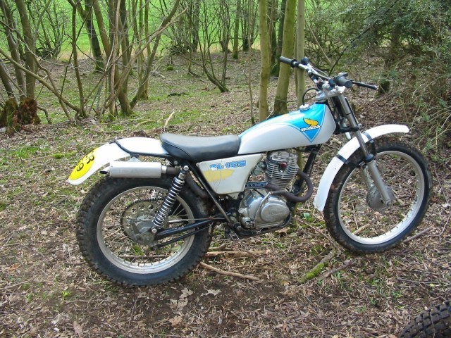

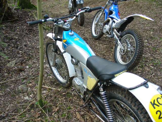

Thought you guys might like a pic of one I saw last Sunday, the engine ran like a swiss watch :rolleyes:
Interesting little bike.
It looks to me as if the shocks top mount has been moved and the jug looks larger than a 125. Am I imagining it?
