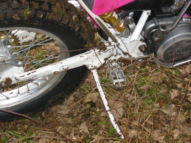

Came from Shirts apparantly, I can only presume there from GAS GAS stock.
Weld straight onto the frame, has anybody else done this mod? if so how much were the footrests?
A good time to move them down and back a bit while you're at it.

they are hebo pegs
Beta boy's right there're Hebo pegs, I just put thm on my 04 Rev3. A mate of mine has ordered Sammy Miller pegs that come with hangers that re-position the pegs down & more toward the rear.
I'd like to figure out how to get a pair of those on my '74 TY250. I had a '98 Gas Gas and they look like the same pegs.
The footrest's come with the hangers, you just grind the old ones off and weld the new ones on, easy on the TY with it's steel frame :rolleyes:
I installed Sammy Miller pegs on my TY175. Although they are back and down from the stock position, I still feel they should be a bit lower. I've got a local welder/fabricator lined up for the work and will report when it's all done. Fortunately the 175 pegs are attached via a bolt on plate. I can definately vouch for a wide peg like the Hebos or the Sammy Miller's, the only way to go.
