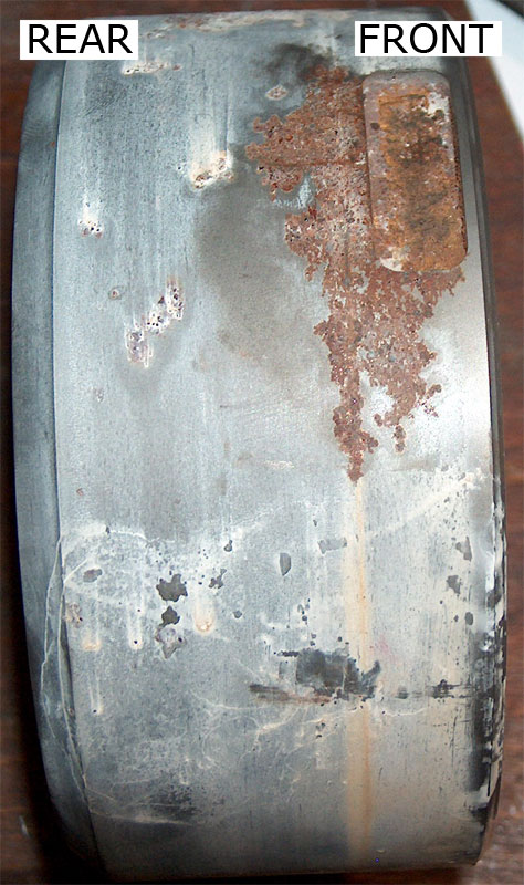

hi, this is my flywheel.

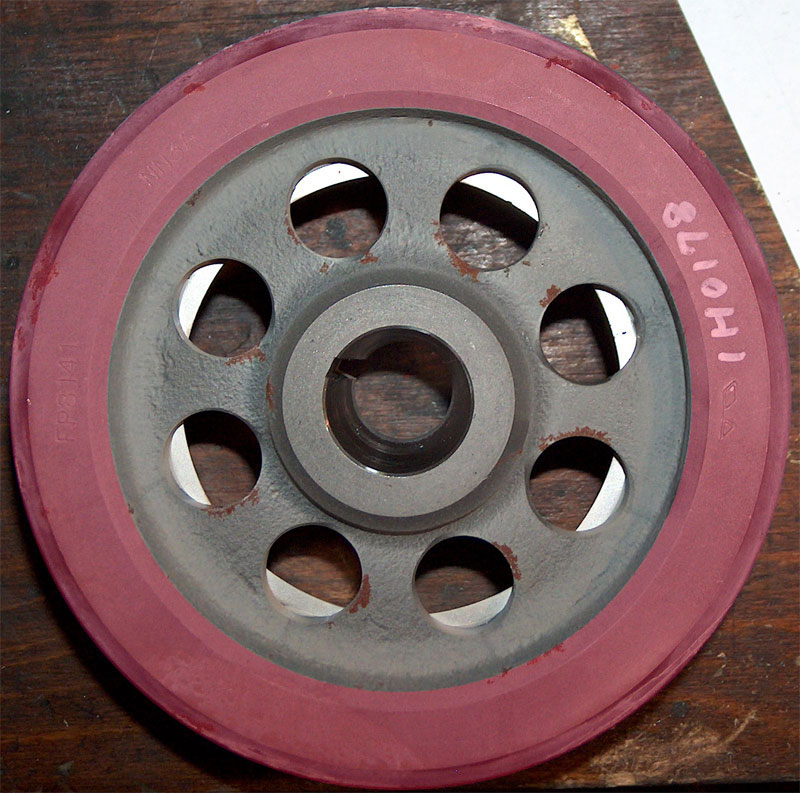

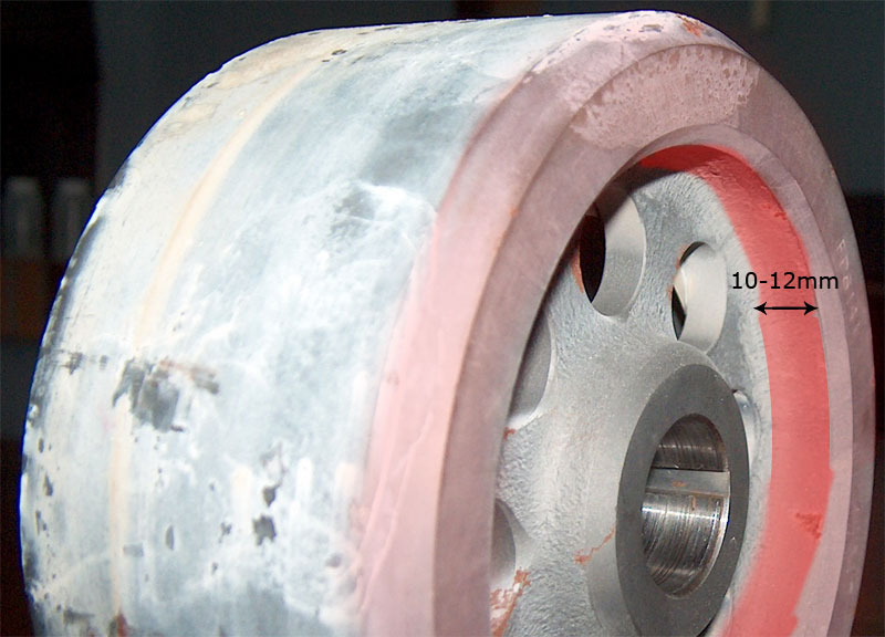

FF could you mark in the photos where i have to remove the material, and how many mm?
tnx...
Edited by bascello
Hi, i have to remove the red marked area?
Edited by bascello
I have done this mod and it is worth it. Just to give a little more info, each 1mm you take off is 60 grams and the 12mm would be 720 grams. I personally took off 10mm and it kept the bottom end grunt but excelled the reving speed and access to the power.
