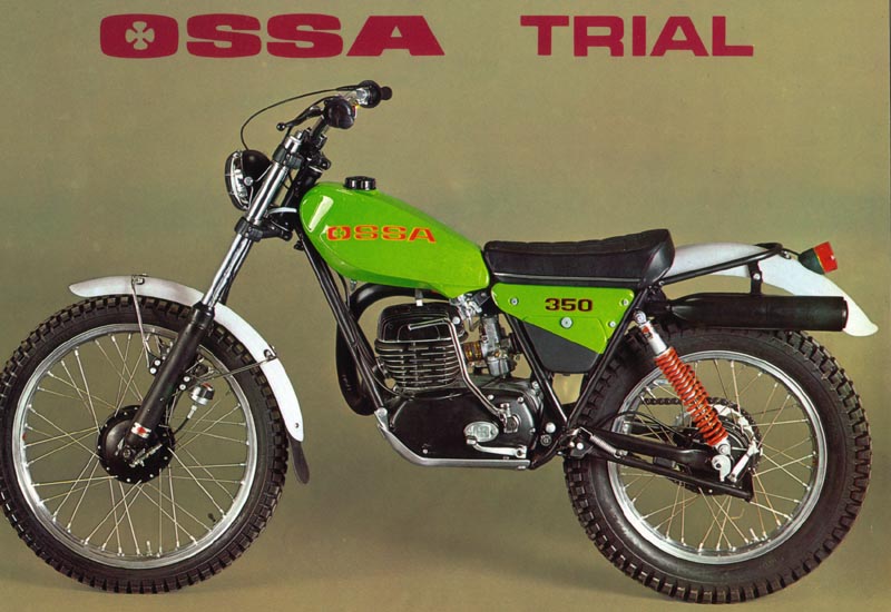

September 18, 200620 yr Hi, seat could be re-covered by this firm, ex trials riders 1st class job! http://www.motorcycleseatworks.co.uk/home.html Is it like this one with the green tank? Could be wrong about this but I think it should have a 26mm BING carb?? Edited September 18, 200620 yr by 2fargone
September 18, 200620 yr Author Hi,seat could be re-covered by this firm, ex trials riders 1st class job! http://www.motorcycleseatworks.co.uk/home.html Is it the one with the green tank? Could be wrong about this but I think it should have a 26mm BING carb?? Hi 2rargone, Thanks for the reply, yes it is a green one and if your right I have the right carb, I will check out the site for the seat. Much appreciated, Vaughan.
September 18, 200620 yr 1977 350 - Green tank, black frame, big curly exhaust and long tailpipe, white mudguards. Should have a Bing as standard as all Ossas were using them by then, went back to Amals later on. Check this site as it has links to all sorts of useful stuff such as parts suppliers, repro parts etc. Also has brochure photos and there should be one of your bike. They also have manuals to download I think - there may not be one specifically for your model but they are nearly all the same mechanically so the earlier MAR one should cover it if not. The site also enables you to date your bike through the frame/engine number - these should match, engine is pre-fixed M, frame with a B (could be the other way around - memory not what it was...) Mats Nyberg's Ossa site Also some pictures on this site of Ossas too and just happens to be one of a '77 350. Canadian website with brochure pictures

September 18, 200620 yr Author 1977 350 - Green tank, black frame, big curly exhaust and long tailpipe, white mudguards. Should have a Bing as standard as all Ossas were using them by then, went back to Amals later on.Check this site as it has links to all sorts of useful stuff such as parts suppliers, repro parts etc. Also has brochure photos and there should be one of your bike. They also have manuals to download I think - there may not be one specifically for your model but they are nearly all the same mechanically so the earlier MAR one should cover it if not. The site also enables you to date your bike through the frame/engine number - these should match, engine is pre-fixed M, frame with a B (could be the other way around - memory not what it was...) Mats Nyberg's Ossa site Also some pictures on this site of Ossas too and just happens to be one of a '77 350. Canadian website with brochure pictures Cheers, Woody, Picture is the bike I have and Mats site is spot on too, very friendly Guy, going to send me the Manual, Thanks a lot, Vaughan.
