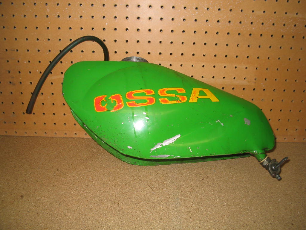

post-3272-1159387168.jpgHi, Can anyone advise how to get a big dent out of my Ossa petrol tank, the bike fell against a wall and has a 7" dent along the length, apart from that the tank is unmarked and still has original paint.
The tank is an Aluminium type, Im located in the UK Co Durham.
Cheers,
Vaughan.

Anyway, if you were around me, I would tell you too look in the phone book for paintless dent repair, or hail damage repair or contact a large body shop and ask if they have someone they use, or your insurance agent should have someone they use.
Basicly, they will reach down through the neck of the tank using spoons and other shaped bars and push the dent back out. It does not appear creased so it should be a relatively straight forward repair for them.
Normally I do this type of work myself, but as it is an "odd" Ossa tank, with the odds of me finding another somewhere between slim and none, and I think Slim fell off the truck,,,, I would spend the money, and have a guy that did that all day, 40 hours a week, do that one.
It is amazing what those guys can do.

Closer inspection reveals what may be a definite crease in what may be an aluminum tank.
Not a job for an amature! But it may work out!

I took that shiny spot to just be paint flaking from the bend. If it is creased there (I looked again and cannot really decide) it will definetely add to the level of difficulty but again, it is all the more where the really good guy at PDR will earn his money.

hi i had a dent in a tak and was told to fill with water and put it in the frezzer never did it but it is suppozed to work as ice takes more room up than water
