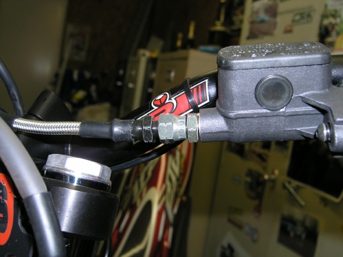

I'm suprised nobody else has answered yet, my bike came with the larger master cylinder already installed so I don't know if the fittings are stock or not without looking at another 4rt. I have been playing with the camera so here's a picture so maybe you can tell. :wacko:post-2409-1164990846.jpg
Yes, that's the same MC as fitted to the 315, it's a straight swap job including lever, the hose is exactly the same.

Just fitted the larger MC and it definitely gives a smoother more progressive action but doesn't totally eliminate drag, or at least it hasn't on mine. like I said above the hose is interchangeable.
