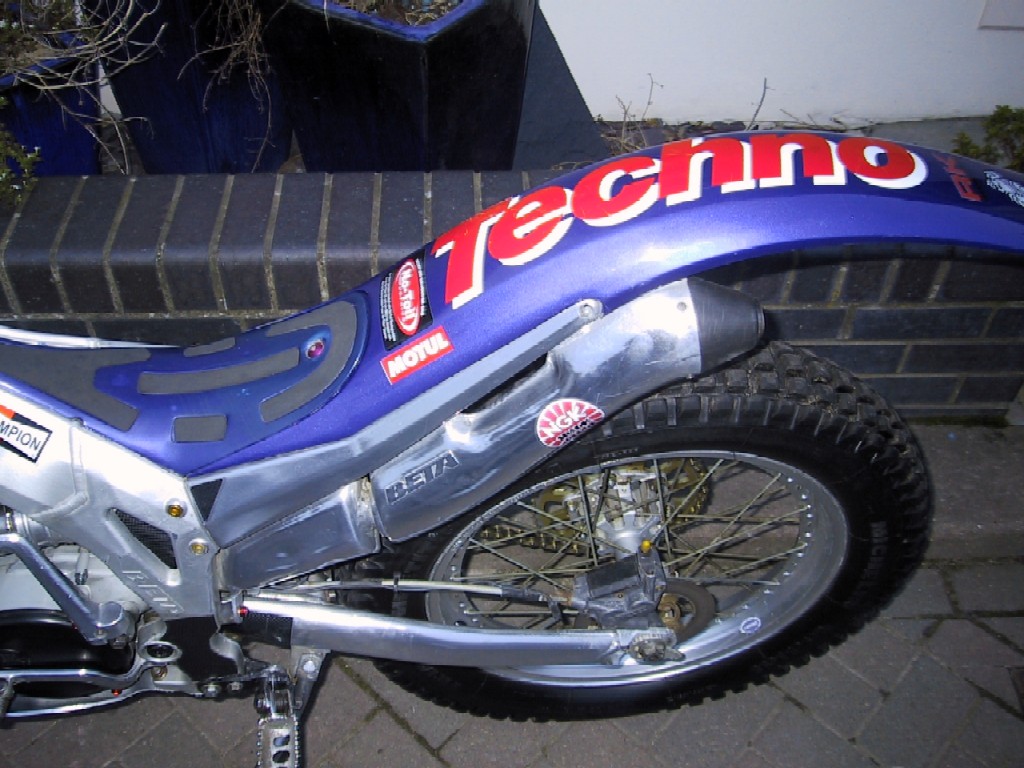

Gez,
first of all, post some pics of your bike as you have the same bike as myself and beta boy. You can see pics of our bikes under the topic 'rear mudguards' in the beta forum.
I think you get different sizes of bleeding breaters, if you can find a larger size breather you should be able to tap out a larger thread and install the bigger size of breather.

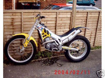

did they technos come in any different colours becouse mine is different to anyhils and beta boys- all the plastics are yellow and it has a yellow/blue strip on the frame. ill post a pic up wen i get a digi camera
gez well those colours arent standard on any techno just to make sure we no what year we are dealing with has it got up side down forks on it is the rear brake a grimeca 4 pot brake and what year does it say on the front and back hubs
here is a piccy of me bake brake not very clear but u will still be able to tell if it is the same as yours or not
Edited by beta boy
well from the picture i looked at they looked black but from this picture they are dark blue my mistake also i have noticed that the tank graphix are the wrong way round and it has silver forks not the standard black ones
