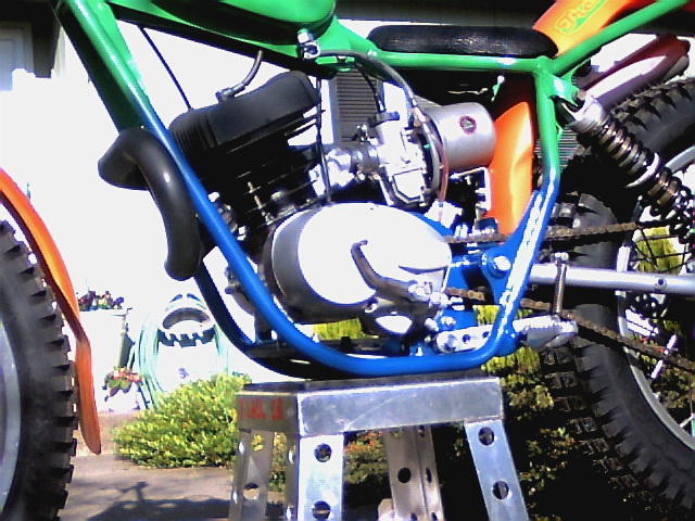

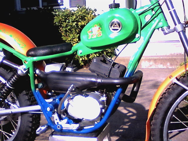

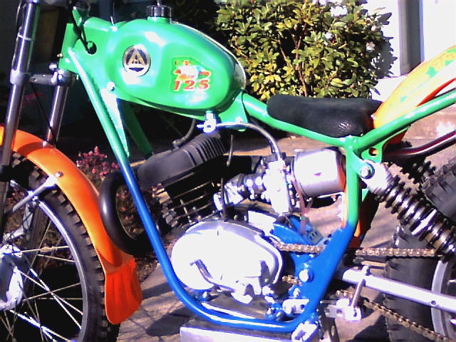

If this works, you should be looking at it. This one is really special. Lot's of carving to try and drop the weight.

The Tree Frog 125 has a steel flywheel made by Ron Liddle, my machinist. It simply costs less than the fine product created by B&J racing. Ron's flywheel requires a Hodaka wombat flywheel for a core, and $250.00 to build one. I think B&J has a gorgeous brass flywheel weight which is $350.00 if I recall correctly. One of the neat things about this bike is the frog skin seat cover. It took quite a few frogs to make it. :) Also the Gonelli fender set from Bultaco UK sets it apart from the ordinary. The primary muffler (centerbox) is a refurbished Bultaco M199A part from E Bay. The carb is an Amal mkII from a 348 Cota.

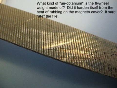

About the Hodaka, turns out the flywheel weight was contacting the inside of the mag cover and dragging on the engine. Also the timing was too far advanced, causing a gutlessness and propensity for stalling. Once the timing was set properly and the flywheel ground off a bit, test rides revealed the nature of the type 3. Power wise it is a timid thing. I plan to try some different combinations until it gets better but it will always still be just a 125. I seems it doesn't rev cleanly on top end so I plan to put a smaller main jet in today.

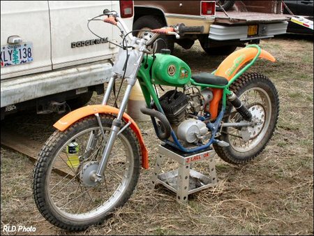

As time goes on I have been fettling the Tree Frog with some further improvements, and it is ready for another outing to test it's progress. The biggest one is a set of very special primary gears to provide super low internal gearing. The first ride with these found first gear to be much lower than before and second gear to be where first had been. Now the little Tree Frog can crawl along at incredibly slow speeds in first gear, where as before it felt like you were being dragged along at an incredible speed, almost like being sucked down a drainpipe. (has anyone seen that animated movie, "going down the drain?) And now second gear allows attacking "larger" obstacles, so it is a win/win situation. This photo shows the bike at the last trials event, where we are required to sport the number of our line. Expert = #1 Intermediate= #2 etc. I had a guy walk up to me one time and say, "So you just decided you were number one?" I had to show him there were eleven other guys with number one also.
At the last trial the flywheel weight had been dragging on the inside of the magneto cover, so Ed and I set about trying to resolve this, with a hand file. It only suceeded in destroying the file. I have since resolved this problem. It is amazing how much better a bike can run when the insistent drag of the flywheel is resolved.

Maybe the file failed because it's designed for low-speed application, and your app was high-speed.
Vintage Cota, I hope you mean funky in a good way. ;) I'm sure that you are right about the file, but it's more fun to say it was because of the high Iridium content of the flywheel weight. I was worried that thing would catch the file and propel it through my eyeball or something. My momma always said , "Stupid is as stupid does." I say, "God protects the stupid."
