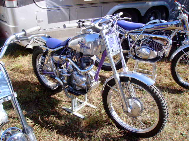

Hi All ; I just got back from the North American Twinshock Championships and I have to say that besides having a great time and not crashing ,
that I got to ride a work of art !!!! a 1960 royal enfeild bullet ... although trimmed down to well under 300 lbs , and a work of art in everyway ,
WHAT A MONSTER!!!!!!!!!!!!!!!!!!!!!!!! you could plow feilds with this beast ! But I must admit it is the most comfortable trials bike I have ever
riden , the stance can only be summed up as perfect !!! Here is the one photo I took of it , but the build process can be seen at www.twinshock.org on the photo page under "reshaping a bullet " More torque than most tractors !!!

Whats up with the TY sitting next to it? Never seen a frame like that. Appears that tank is in the backbone. Any info on it?
It looks like a Suzuki RL 250 motor in a Fraser Honda Frame (TL125), could be wrong.

No, this is my recent creation from an original 1960 Don Morley factory Trials 350 Bullet. It was last used in the UK in the 2005 pre 65 SSDT. I imported it in Nov 2006 and then spent some time working out how to make it more competitve. The frame was hacked and the swinging arm moved inside the primary case and gearbox, shortening the wheelbase from 55+ to 51. Head angle changed and engine raised to give 12 ground clearance. Yam back wheel fitted and now rear brake, gears, and kickstart all on the right. Will be in action during 2008 as this year it was the Tiger Cub as the main weapon.
