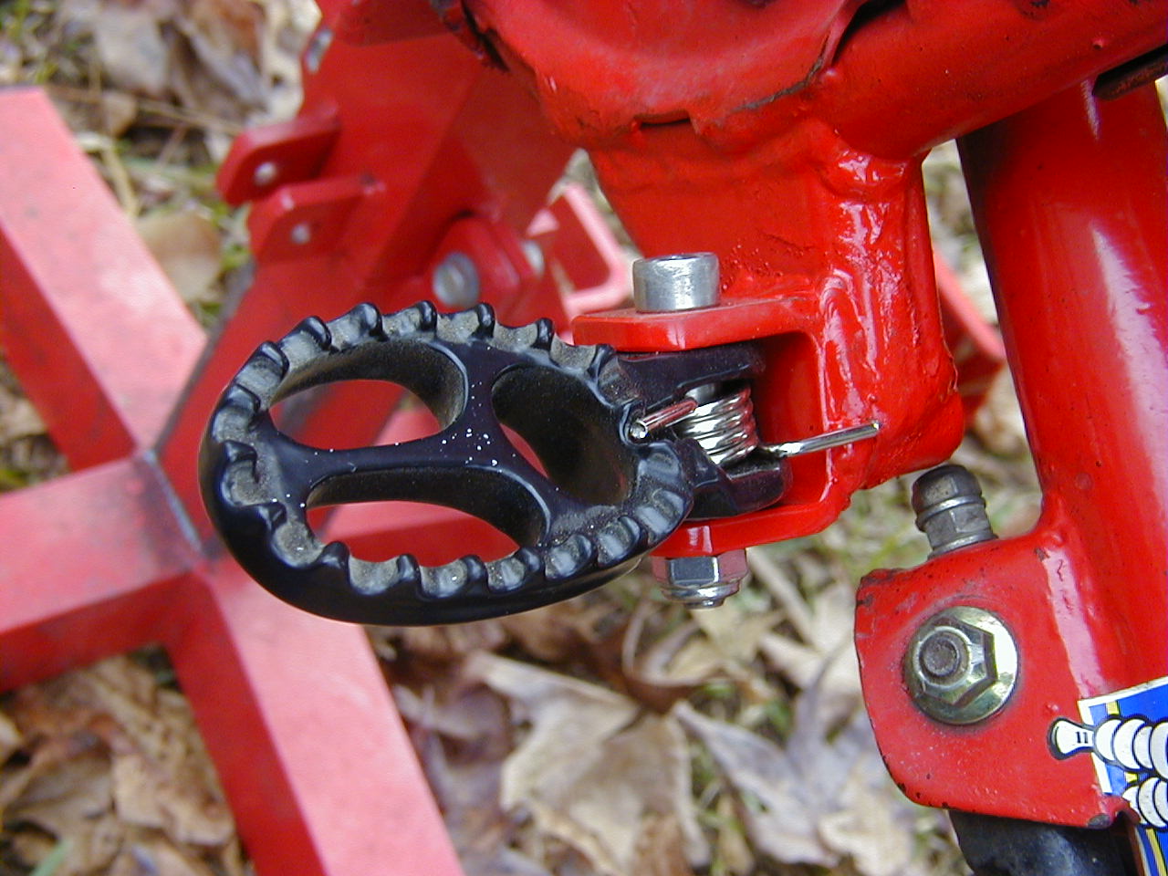

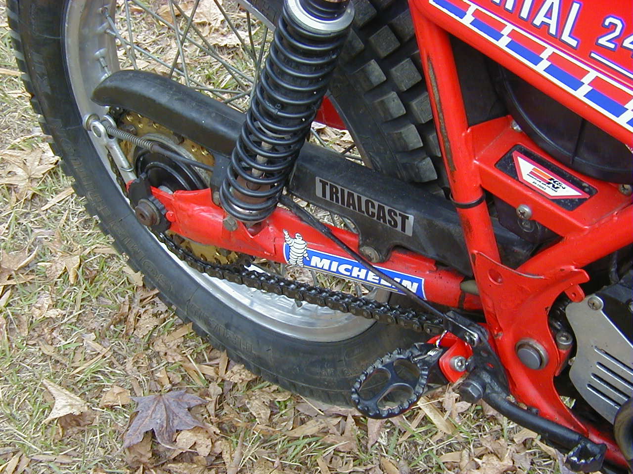

Well I finally broke down and bought some ghost pegs and brackets ! A little cutting and the use of my neighbors tig welder and my old girl
has proper modern pegs !!!! I moved them back and down about 12mm too . welding the brackets on parallel to the top edge of the mounting
ear kept them level to the ground . And their chain adjuster cams fit the swingarm knubs better than the OE. adjusters did ! A wide footpeg makes such a positive improvement in how the bike feels under me ...
