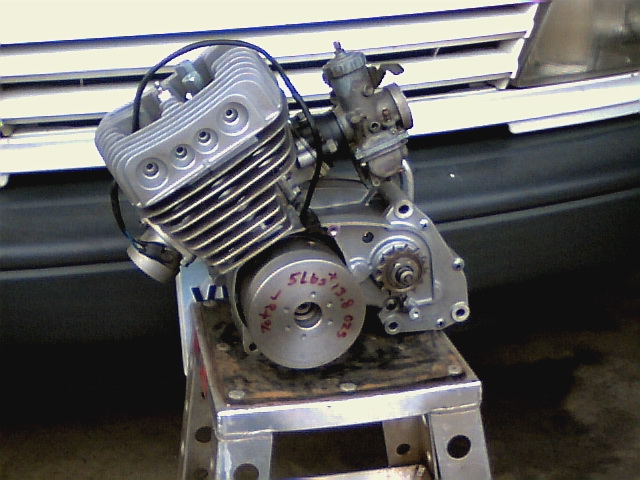

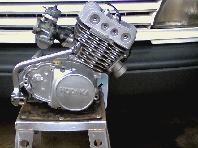

Haven't built the rest of the bike yet, but I thought somebody out there might like to see these ultra secret photos from the Hodaka trials test and development center here in beautiful Oregon, the birthplace of the Hodaka motorcycle. I am envisioning a bike that suits this gem.

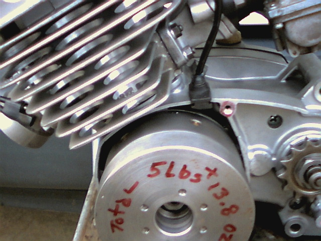

I'll try to fill in the blanks a bit. Where to start. This is based on early 125 Wombat (94) center cases and transmission. The cylinder and head are from the late 125 Wombat (03). The crankshaft is a hybrid made from the 94 left crank half w 94 rod kit, and a Ace 100/B type right hand crank half, which allows the use of the 100 cc primary gears and clutch, thus achieving much lower internal gearing. The Ace clutch is modified to exacting specs to withstand monster clutch burnouts needed for trials. The custom built flywheel weight is fitted to a model 94 flywheel magneto w points, which is set to stock specs of 2.4 mm btdc.

As far as the mystical chassis it will probably be parts to a sherco, and it's hard to say how ambitious I will get. The bike will probabbly be evolving for the rest of my useful lifetime. :thumbup: Yes I hope to ride the B class in modern trials on it. As long as the sections are reasonable I should do ok, but I dread trying giant steep climbs on this imagined bike. It is not exactly a powerhouse, but it does ok. Hard to imagine the Hodie motor in a modern chassis, but that's the plan.
Before you panic that I am bent on destroying a good Sherco, think again. I intend to make the job sort of convertible, in that I intend to build the Hodaka using a scrap frame from a local Sherco dealer's warranty dept. then the rest of the parts can be transferred between the actual sherco and the Hodaka Sherco hybrid.

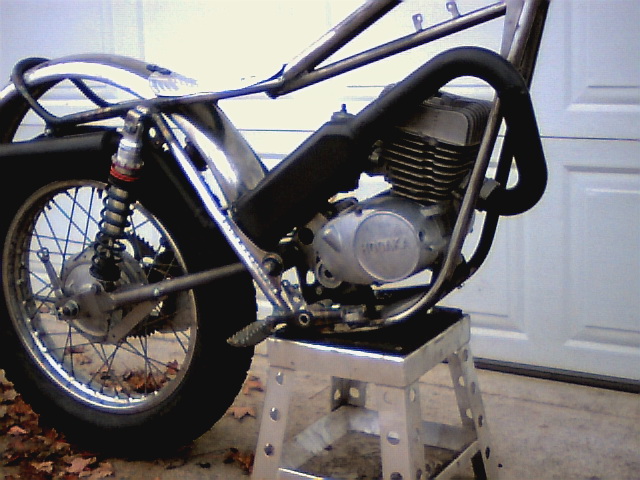

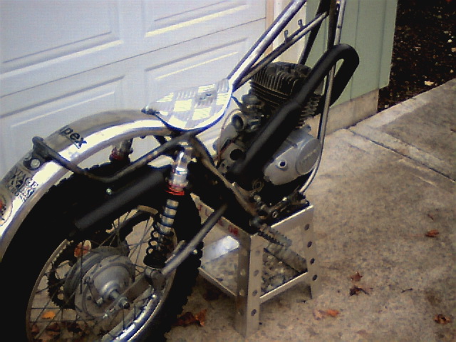

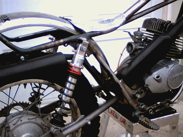

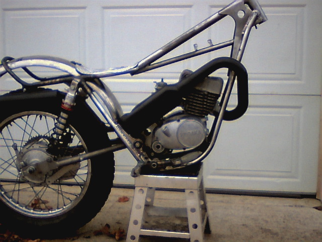

I agree with you! Thought I'd post a few shots of the rolling chassis I built for Bill Cook of www.hodaka-parts.com He has his own hand picked collection of Hodaka creators, and this bike will have the best of everything if I know Bill. I call this one the Classic Tree Frog. Rumours of a red plastic Bultaco tank are afoot. That should look purty. This frame and exhaust system are the product of about 60 hours work, then the front fender mount is another 6 hours to build, but they sure are cool. I build the fender mount to adapt a Combat Wombat front fender to the chrome Hodaka forks.
:thumbup: TOO COOL !!! but wasn't there a hodie model named after a frog ? I always wanted a dirt squirt to replace my suzuki 90 in my early enduro days ...

Check out the hodaka-parts.com web site for a brief comment and photos from my sponsor, Bill Cook. I recently finished building the frame and exhaust system for this bike. Tree-Frog pic
