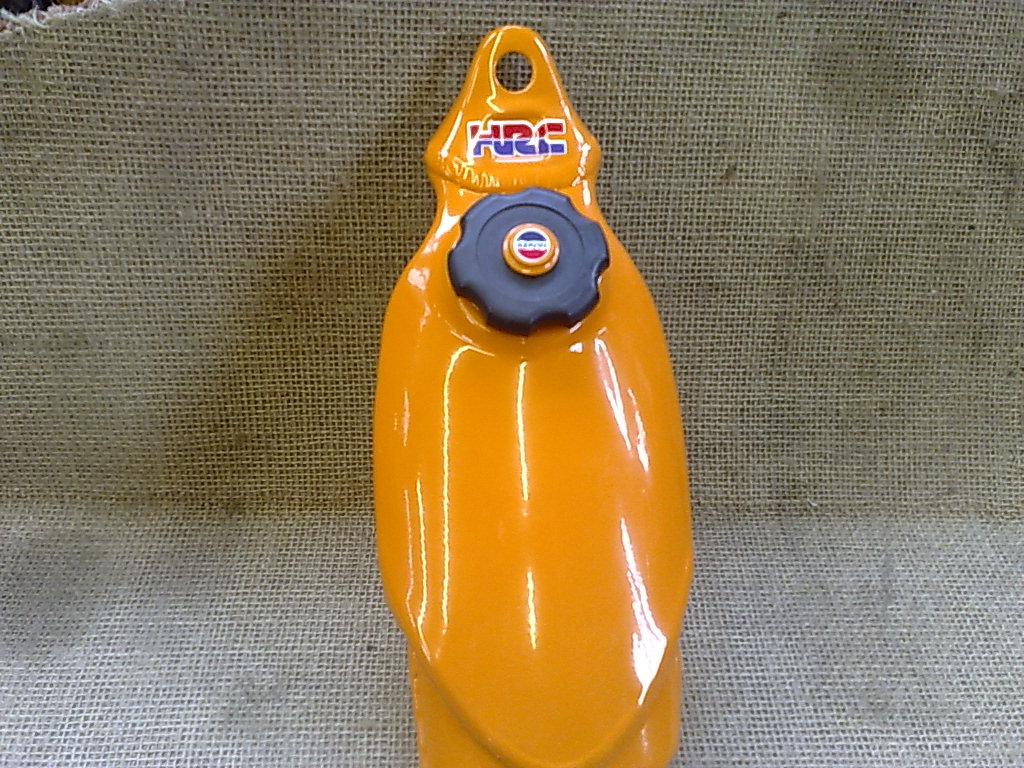

Home made Flattank
Yes your photos look like a LOT of hard work ,
Like I said you need a Very Good Engineer , I see what they do at TRW to there tanks and they dont touch the bottom of the tank at all like your photos show you have done , They just cut the top of and make a new lid , OK easy if you know what you are doing ,
But with your photos and a Good Enginneer then should work out great , And save all the extra money if you had to buy one ,

Did you make a couple? after all that jigging and fab work.
If so pm me with details as i would like one.looks really nice
I have made a complete new tank, bottom and all the rest and have nothing changed to the original tank

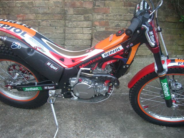

A firend of mine has done this with his tank, the rest of the bike is not bad either........
Top of tank removed & flattened, bottom tank expanded to increase fuel capacity. Perfect idea really, large capacity flat tank.
wow great job Bas !! did you use an english wheel to get the shape ?
