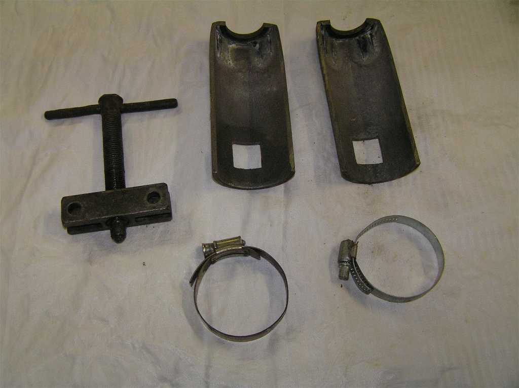

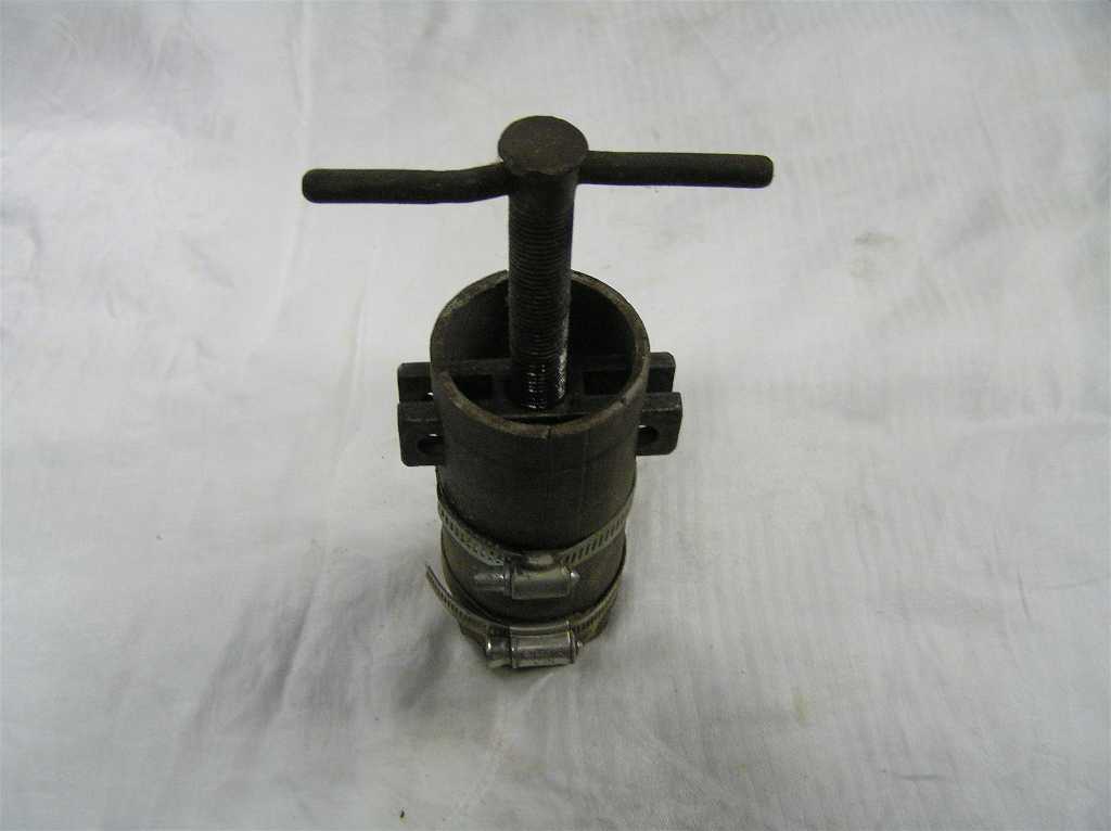

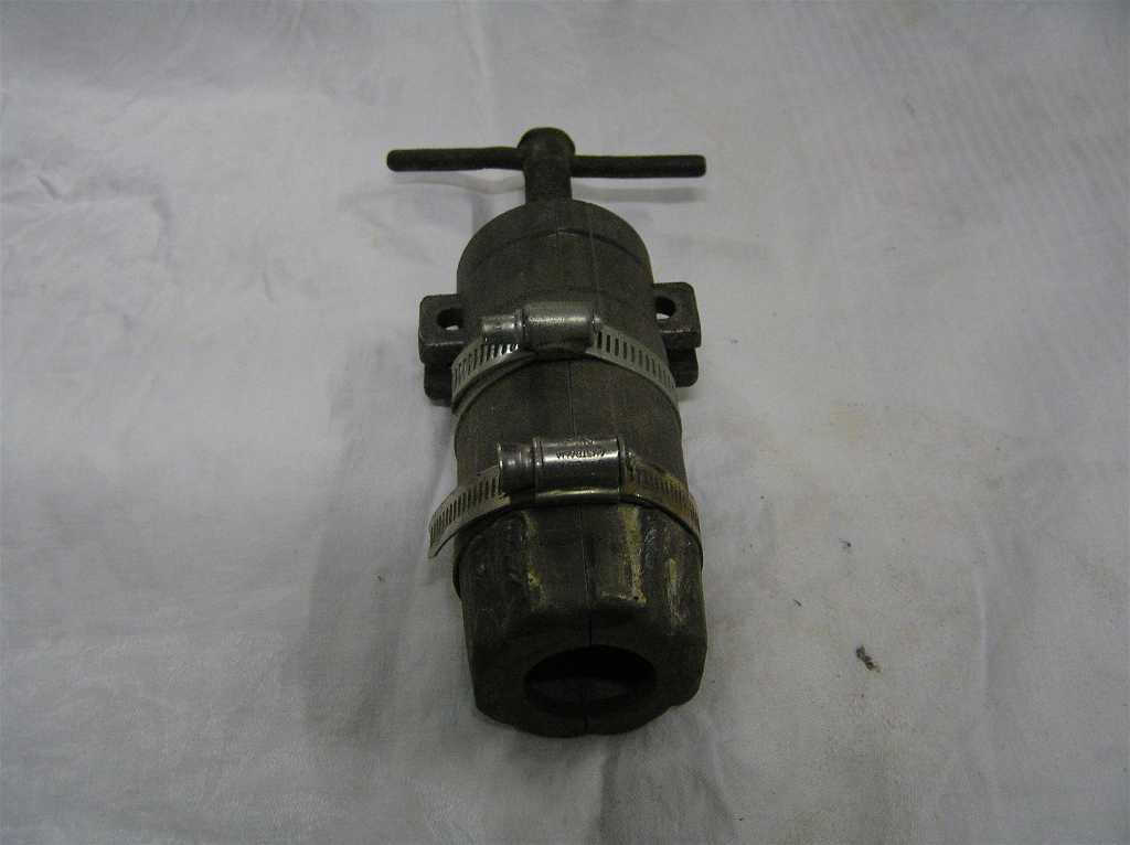

feetupfun Posted December 6, 2008 Share Posted December 6, 2008 (edited) I had to take that gear off my 348 and I'm assuming your 247 has the same sort of taper. I found that a gear puller with fingers couldn't put enough force on so I made a tubular puller that has a full circle shoulder that goes behind the gear. It is made in two halves so it can be fitted over the gear, then the two halves are held together for the pull. It worked. I think that sort of puller is available from Montesa specialist Jared Bates or can be made with a welder and lathe. Edited December 6, 2008 by feetupfun Quote Link to comment Share on other sites More sharing options...
belldane Posted December 6, 2008 Author Share Posted December 6, 2008 Thanks for the reply Feetupfun Yes the primary gear is the same as the 348. I rebuilt my 348 a couple of years ago and there was no drama getting the gear off. I actually made a puller very similar to the one you sent me photos of. No problems it just popped off. This time, however, when I applied the pressure the welding came undone ( no doubt my sh welding job) I think I will get in touch with Jared. he is very helpful and have had dealings with him over the years. I think the angle grinder is looking really good at the moment as I have other primary gears the same. Will keep in touch and let you know how I finally get this b-----d off in case you ever come accross the same problem. Thanks for your help mate. See ya. Belldane Quote Link to comment Share on other sites More sharing options...
