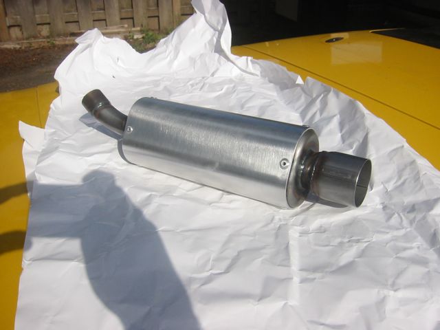

Hello all, has anybody ever tried to make, or get the middle section of the mar exhaust made from aluminum???.
I may no sombody who may be able to make one, and im interested in asking him to giving it a go!!. Any advise or help would be very gratefully received.
Try to make it at least look like the OEM part, but repackable you then might be able to sell a few to pay for the project.
I started a similar project sometime ago (Years!) for another popular Spanish bike :thumbup: Might be worth resurrecting as I even got around to making half the press tooling.
Wayne...
I was going to make a muffler like that for my Bultaco. I bought a used muffler (an FMF I think) but was going to need to cut the ends off and weld up something to make it work. In the end I got a Sammy Miller one and gave up trying to modify the used one.
You might look at the Sammy Miller one and see if it could be modified.
