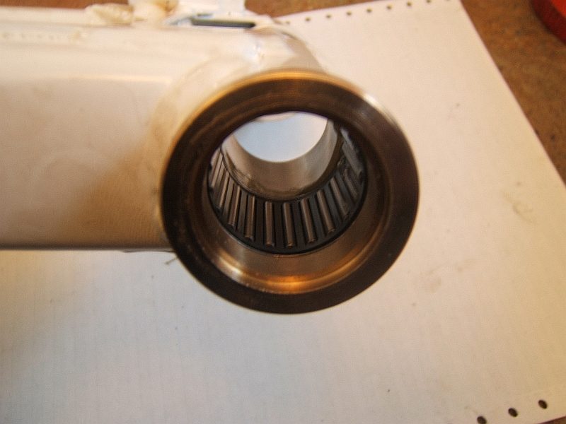

Some progress today. Fitted a little mod which has been in development a little while :closedeyes:
Wayne....

looking good, love those swingarm bearings
I was pretty damned pleased myself how it turned out in the end.
