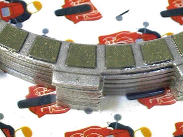

Surflex Rev 3 Clutch Plates.
Hi I have been jsut looking on trialsbits and noticed a set of six suflex Rev 3 clutch plates, they claim to stop the fragging clutch. Just wondered if anyone had tried them? Here is a link and a piccy...... :lol:
Thanks in advance,
Lloyd ;)
The link...
and the pic.......
