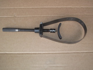

November 27, 200917 yr Here is an old Bultaco flywheel tool that I've used since the 1960's. It works great on different size flywheels and as requuired could be made locally. Edited November 27, 200917 yr by nh014
