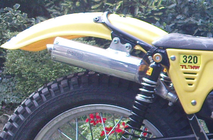

The best mod to do is run an modern core striaght through type ally silencer.
I have been running this setup for nearly a year and you would not believe the difference
it makes. Bike 'breathes' easier and has a bit more power and revs cleaner.
Another mod i have done is to modify the air box to accept a an air filter with bigger
surface area and fit a less restrictive airbox lid to aid improved air flow.
This combined with correct jetting and the modded full exhaust system
makes a HUGE difference to the bike.
The std silencer is a little too restrictive and heavy , but there is no off the shelf
silencer that will fit , only maybe a flat type TY mono silencer.
I had to get mine custom made-

As Peter has mentioned, don't muck around with the mid-box; i removed the packing from one i had and the performance suffered (a lot). I had a look at the maddog rear pipe and its good; I converted a WES TY250 rear pipe for the Beta and may now do the same for the SWM.

Hi is there any advantage in changeing the tail pipe or is it best left alone ?
if it`s in good working order the stock setup works fine.my #1 bike i ride is bone stock and i`ve never needed more power and i`m about 260lbs and ride expert..but if you want to mess around take off the silencer and ride the bike...it`s loud but alot more zap! there`s more power to be found there if you make a different silencer..but don`t ride the bike without one of somekind...

since this was posted has anyone come across a replacement tailpipe that's a reasonably close fit...I won't add lighter...could anyone make a heavier one :P
Nope looked at a couple for mine - just out of interest but nothing was close to fitting, to be honest my bike always had that much power when you want it I really don't want any more! I could pull 4th gear up just about any hill you could mention, its possible my disc has been modified as it seems to have a lot more go than the other 280s I had a go on.
