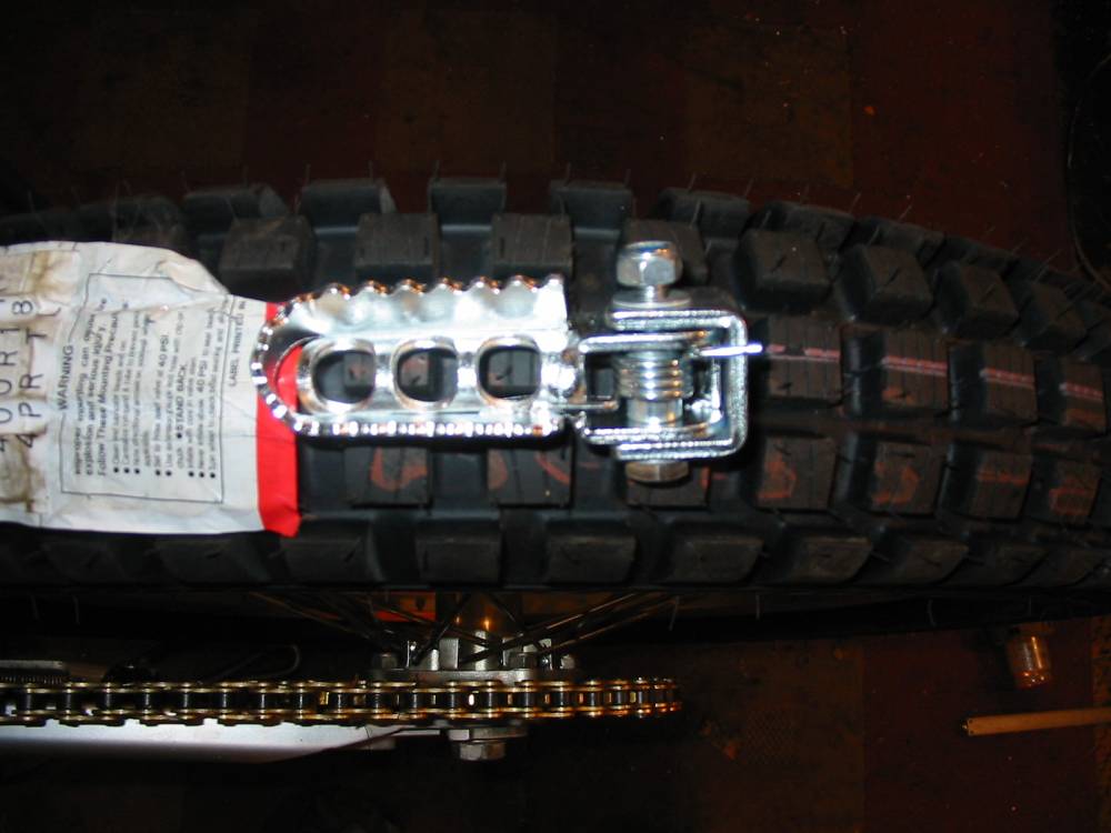

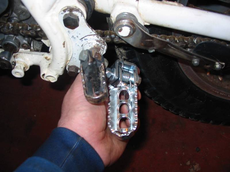

Would this be far enough back and down ? I've got to wait untill I get back to work before I do the job.

As Woody says you would have to weld on new mounts, but at the same time would be able to fit wider modern rests. I would suggest a pair of Control footrests, which come with mounts, springs, and bolts. This would be a major improvement over the very narrow std Honda rests, which are not that fantastic for serious competition work.
This is an excellent mod for any older bike, but dont move back more than about 12mm, as if you fit wider rests, this will be the same as taking the std ones back 25mm.
Already replaced standerd footrests, ones from hondas trail bikes, go straight on, XL 250 i think. About
