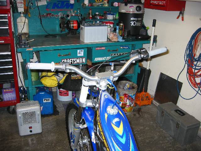

January 12, 200521 yr I put Migura, fat bars on my 99 Sherco, you could probably put that tripple clamp on the top, after that year they changed the top clamp so the bottom bar mounts were cast into the clamp. Or ask someone with that year model if the would exchange both should fit each other.
January 13, 200521 yr Author I put them on my sons Sherco with the 99/00 top clamp. Very cool. Where did you get the fat bar clamps from though?

January 14, 200521 yr Hey JT, where is the cool looking Gas Cap from, I do not think I have ever seen that one. Someone was making an aftermarket top billet Triple Tree for the 99's. I put one on my old Techno that I had bought used (the triple). I will try and get a look at it this weekend and see who machined it, if there are any marks.

January 16, 200521 yr Hey JT, where is the cool looking Gas Cap from, I do not think I have ever seen that one.Someone was making an aftermarket top billet Triple Tree for the 99's. I put one on my old Techno that I had bought used (the triple). I will try and get a look at it this weekend and see who machined it, if there are any marks. I got the gas cap at from Lewisport , also some KTM 's take the same gas cap as the sherco because the gas tanks are both made by acerbis and there is a lot of aftermarket billet gas for KTM's. I would like to know who makes the aftermarket top tripleclamp if you can find out.
