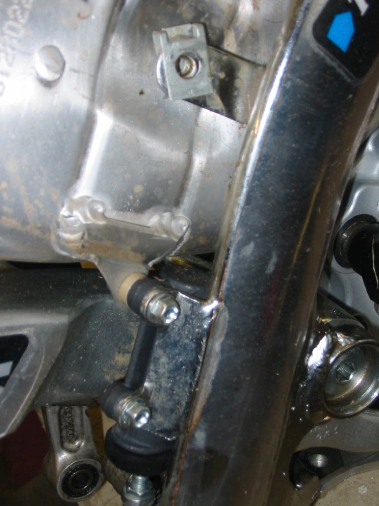

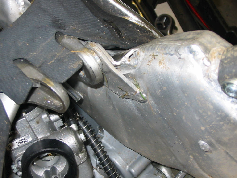

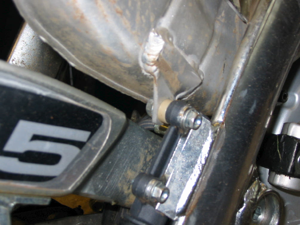

that is totally normal on pro's, i have had three so i should know. The pro will go round scotland with not to much bother if your kind to her. But one prob you might have is the center box as they are renowned for dropping to bits when they get hot and shirty advised last year tht everyone put a steel one on just in case. I had a 04 300 and mine went i was doing the french four day gutted!!!!
Come on then Perce lets see them. (the pictures that is)
Oh all right then Pretty pretty please.
Pictures of my 05 pro.
Exhaust brackets were modified before the bike was used by Al the Spanner at White Bros. I rode last years SSDT with the bike as per standard but the middle box exhaust mounts were cracked by the end of the week.
