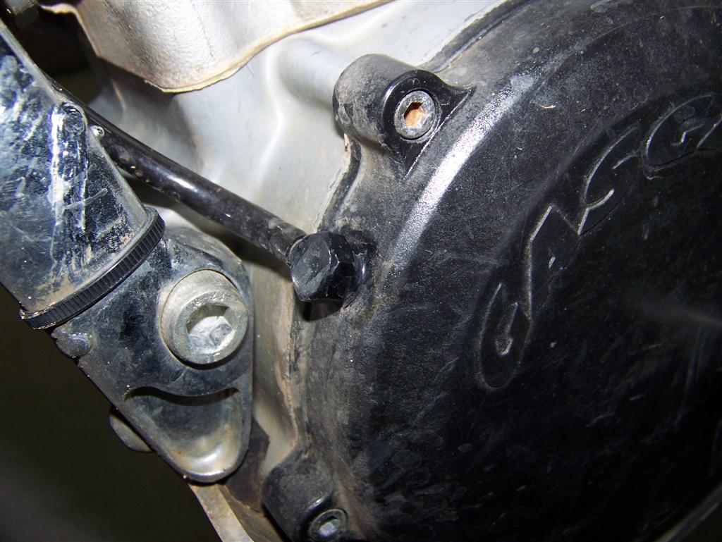

One of the things I've done to keep water from being trapped in the stator area is to vent the sidecase on all my bikes since the 70's. This really helps in a wet Trial as the sidecase is a closed container of gas (air in this case) and if cooled rapidly (like in a creek) a vacuum will form and suck water into the case in any area where the gasket/seal is compromised. A cut down Schrader fitting can be used or any small fitting that a hose can be attached to. The hose is then run up under the fuel tank and into a small coil. I check my stator once in a while and spray some WD-40 on the surfaces just to cut any corrosion possibilities. It's been clean and dry for 8 years now.
This is my 02' Pro vent, which is really needed as the 02' engine is non-anodized Magnesium and really prone to corrosion if not cared for.

thats a good idea,i have sealed up casing with silicon,so will need to vent it i suppose to let it breath..
