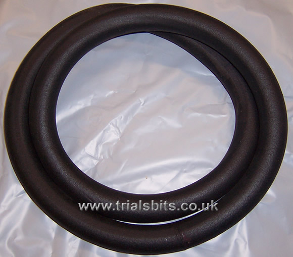

I paid through the nose for mine from Spain. Now available from www.trialsbits.co.uk.
They do say you can get it inflated with a foot pump with one of these beaders. I managed it once, but it's not reliable.
Needed to cut 2 inches out of mine and superglue it back together.
