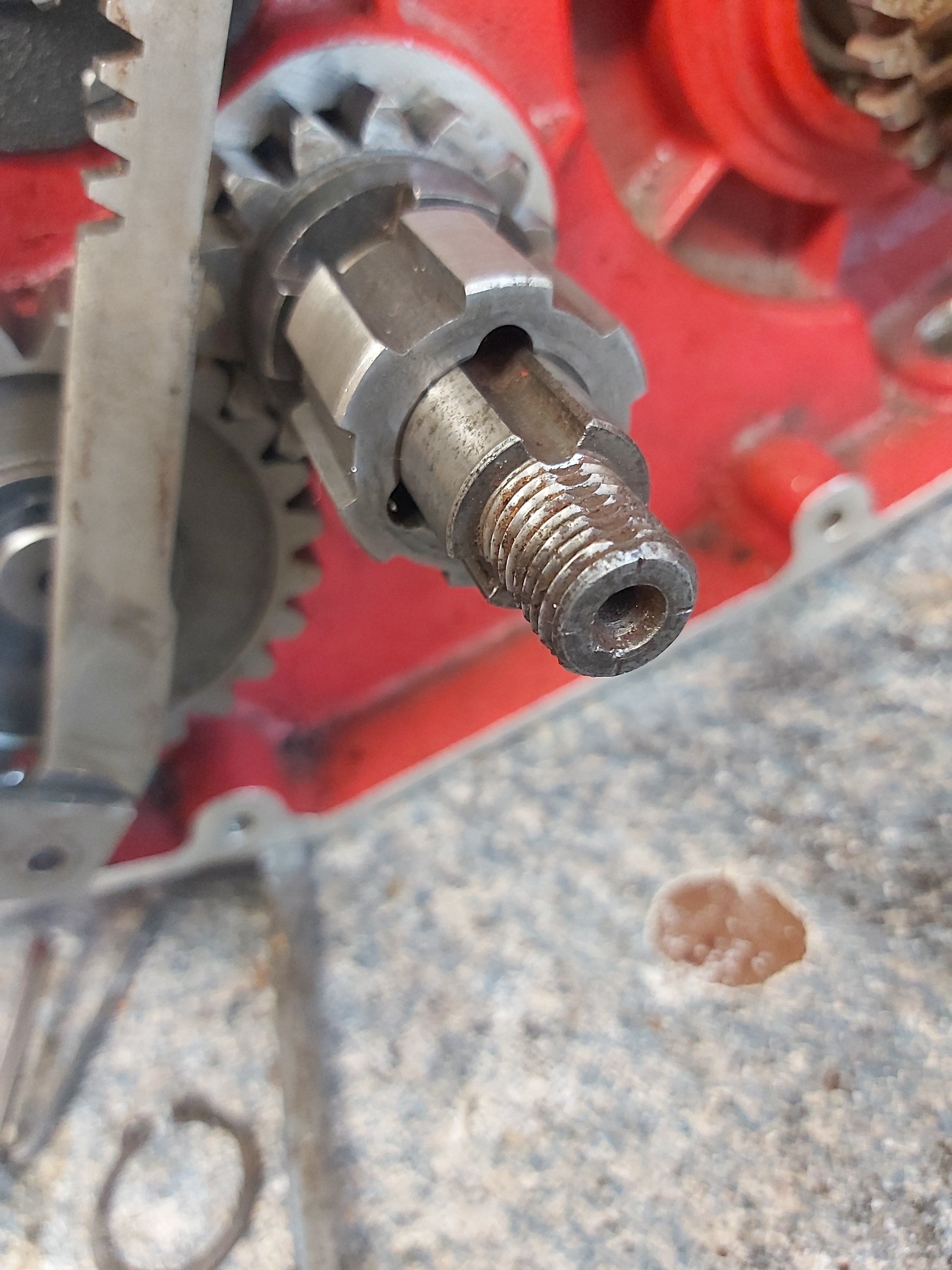

Spoiler
20200523_124711.thumb.jpg.1469c844e24ffcd773e00af643ec8d47.jpgshould something go in those 3 holes its were the clutch hose on and if there should dose any one have pictures please
