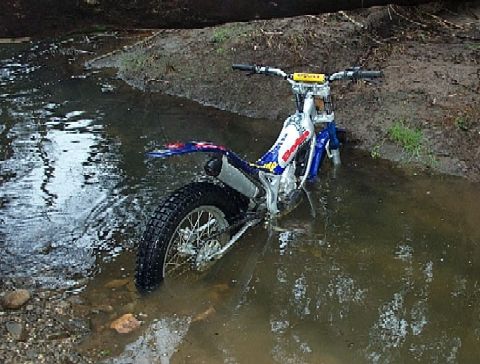

This was found in a Gas Gas Airbox recently... A tiny Beta. :angry:
Hey!  get your own jokes!!!!!!!  Or pay me some commission :D
Didn't say where I ewas going to use it. :angry:
