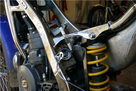

There are three 2.9 sherco's running around this area with nothing but a piece of clear tubing in place of the reservoir, vent DIF just left the fluid half inch shy of the top and wound a little bolt in the tube to seal, then ziptie the tube to the frame in front of the shock.
Why!!! my RTL only had a tube and if it was good enough for them it's good enough for me.
Problems, three years on and not come across one yet, but don't take my word for it.
I can't see any reason why this wouldn't work, clear tube gives a visual indication if needed, and a breather if you think that there will be any need for expansion or contraction. As ishy says it works fine with a bolt.
I'll give it a shot.
Any chance of a photo ishy?
First few I did were 1/4 clear tubing with a bolt stuck in t'end, my 05 I got a bit creative and spent seventy five cents on two vacume hose connectors and a rubber vacume hose plug to cover one end, this made it so I didn't have to use a full hose just connect to the factory hose and job's a good un, took a good twenty minutes to do job.

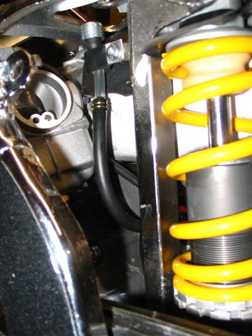

Decided to do it and basically copied ishys idea of having a clear tube as a sight glass, with a hope vent. Photo shows it in position without being tied back with a cable tie ti seat frame tube.
