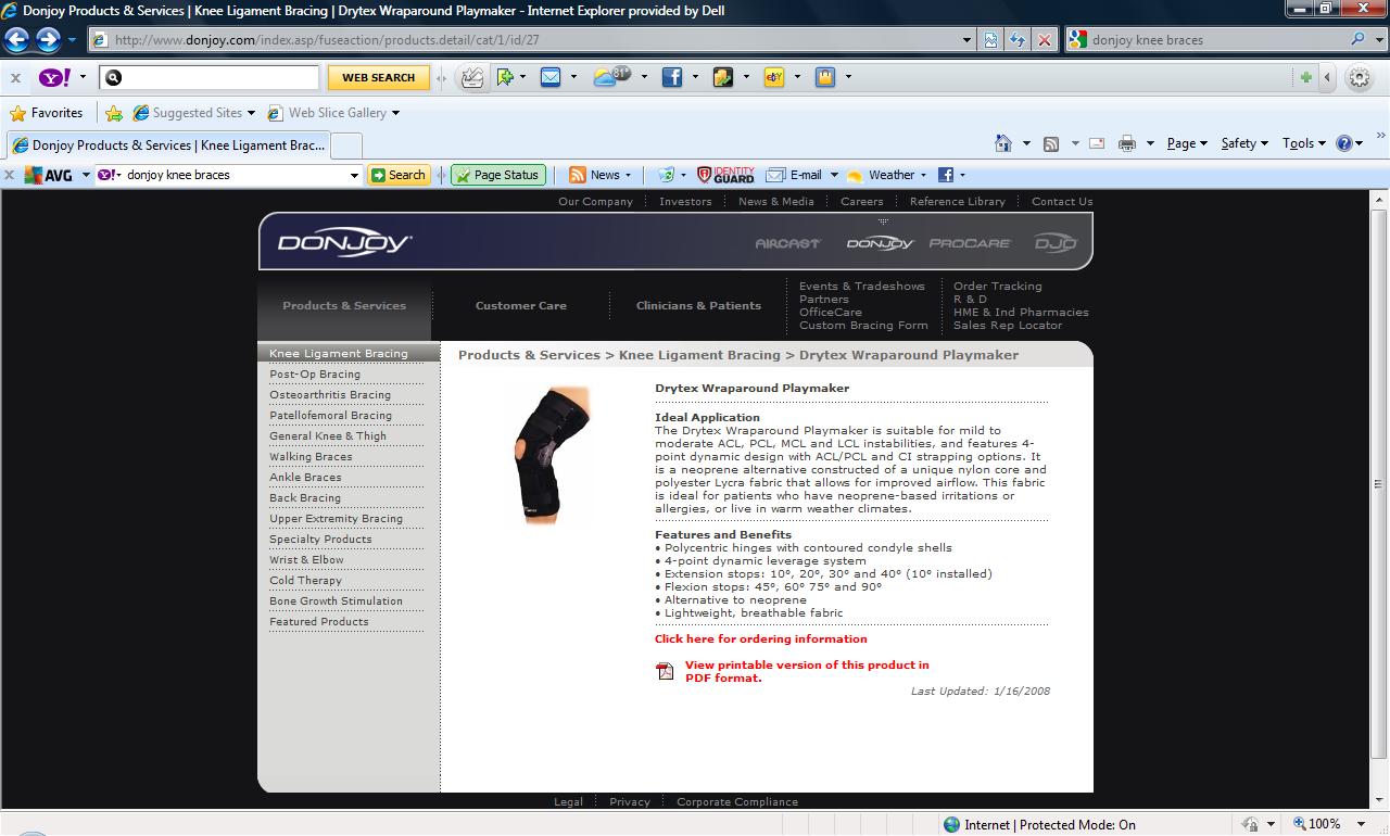

I do not think you are over reacting.I would recommend them to anyone riding, by the pair, as cheap insurance as well as added support. The width of the hinges takes a bit of adjustment though. They will Just cram in under my trials pants, work better with loose fitting jeans or enduro pants. Come down to near boot height. Just a good bang against the frame kills me othwewise! Ouch!
Big thing here is I also use a youth type shin guard with a good knee cup that goes on the outside and tucks into the front top of the boot which has saved me a few knee caps!!!!! (common plant point)
With boots, shin guards, the side rails and hinges and knee caps protected, can feel like Ironman if you take a fall---- with one exception, the bum!
I also have some lesser ones that just pull on, with just two straps, different mfg, and some much more expensive Donjoy ones of the rigid type, yet these have been the favs.
These are moderatly priced and I have had good luck with them.

In dealing with the brace isssue, if insurance covers the brace, certainly go for a custom fit brace recommended by your orthopaedic physician. DonJoy and Breg are the most commonly used where I'm from. Having an integrated guard may help with protection during any falls. "IF" you're an active individual and continue having symptoms of an unstable knee, I'd be surprised if the doc doesn't recommend reconstruction. Either way, hopefully they have you on an exercise program designed to strengthen your legs(specifically hams and quads). Other than reconstruction, strengthening will be the next best thing. Oh, and avoiding those long dabs! As for the Beta, have had no problems and love the 200. Just don't let a new bike take focus away from rehabing that knee!
